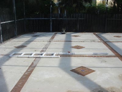

This cannon is pretty plain and simple
Specs:
Firing Valve: 1.5" Ball valve (Firing water)
Chamber:
- (13) 1' 2" Sch40
- (2) 2" 90 degree elbow
- (9) 2" T's
with some other stuff that I didn't measure :P
Barrels:
- 4' 1.5" PVC
- 4' 2" PVC w/ transition from 1.5" to 2" and nozzle from 2" to 1.5" at muzzle
C:B - Approx. 3:1 to 4:1
Firing water:
45 ft+ effectiveness (Stayed pretty straight/on target)
Recoil:
The cannon would slide back 2-3 feet
(I can't carry the cannon by myself because I have to hold the barrel up in order to keep the water in and it's sorta heavy + im scared of holding)
Reason for all the T's and vertical pieces:
Gives support from the recoil caused when firing water (Over-under designs are destroyed when shooting water)

Hahahahaa... Jump back jack. Your gonna drowned somebody with this,lol. How much pressure was used in the video clip? Job well done! :D

The video was 50 PSI or maybe 40 PSI

looks like a lot of fun :D
I would add some kind of lever to the valve handle for easier/faster opening.

I was thinking about that but I was scared because if I make a handle, then it might take me longer because its a farther distance, thus the recoil will be in play and I could hurt my wrist/hand.
With this cannon, I rarely am able to fully open the valve. Sometimes Im even scared of firing :P I already cut my finger somehow because of the recoil

Bring her up to 100 PSI and let her rip down the street with some taters!

A bit scared to go up that high, my dad's limiting me to 80. I only fire at max 50, scared to go up :P

You say scared, but thats actually just wisdom. Dont overhaste and do stupid things, recoil can do terrible things.
Your barrel/reservoir looks like it has DWV reducers.
You should replace those, and then experiment with smaller nozzles. A larger reservoir is also an option.

2nd injury :P I have cut my finger twice already (there was some blood) because of where my hand is on the valve when the recoil kicks :(

I would mount a handle on the ball valve such that as the cannon begins to recoil, your hand would tend to open the valve further.
as to the cuts, wear gloves :wink:

you should build a stand for it, that way it doesn't recoil, im sure you could find some desighns looking around spudfiles
