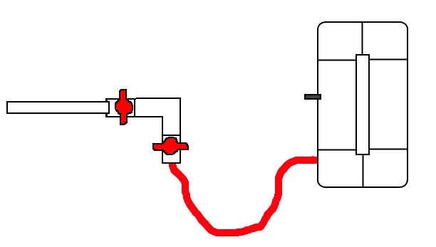

alright mate, I will give you what I think you should do,
Make an even bigger tank, something big, maybe even backpack sized, then have a (pressure rated!) hose run from that to a ball valve (we will call it A), then from the ball valve through your smaller chamber, then to the next ball valve (we will call it ball valve B) , then barrel.
You fill the big chamber, then open then close ball valve A to fill up the small chamber, then open b to fire, close b, then open and close ball valve A ETC ETC...
gun 1.jpg (27.18 KiB) Viewed 5596 times

I thought about something like that but I need portable. I will be running through dark rooms getting shot at from odd angles and such while carrying and using an airsoft aeg. A backpack would weigh me down. I think that a co2 tank with a pressure regulator is starting to sound like what I need and I might make a breach loading of some sort and figure out a cartridge setup of some sort.

sputnick wrote:alright mate, I will give you what I think you should do,
I like the backpack. I would add an air compressor regulator to it. Many fields have a max FPS requirement. With a regulator, you can get several shots at full power before the pressure drops off. If using a CO2 or Nitrogen tank, the backpack is much smaller. The downside is the $$$$ for the setup :(
