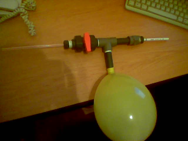

Nothing special or powerful just an idea I came up with to make use of some old PVC and fittings. Basically its a balloon powered BB laucher which requires no pump, no tyre valve and no PVC glue (the parts are held togheter by wrapping ptfe tape around the pipe and jamming it in the fitting).
You close the ball valve located next to the handle (in crude trigger position).
You remove the stopper from the back end of the gun (a pen in my case) and blow through the hole in the endcap. This causes a balloon to inflate at the bottom of the handle (it was previously crammed inside the handle). Once the balloon is big enough hold the end and put the stopper back in the mouthpiece. Now its locked and loaded, put a BB down the barrel (Mc Donalds drinking straw) and open the ball valve to fire.
By opening and closing the ball valve quickly I get about 10 shots from one fill , but I have to load a BB for each shot (have no clue how to make a hopper for a straw).

The gun ready to fire.

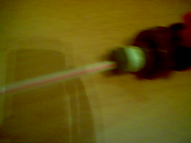

Stopper i.e. pen
Stopper i.e. pen

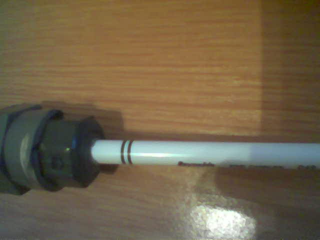

Barrel i.e. straw
Barrel i.e. straw

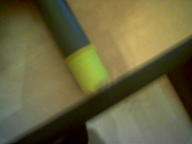

Balloon inside handle.

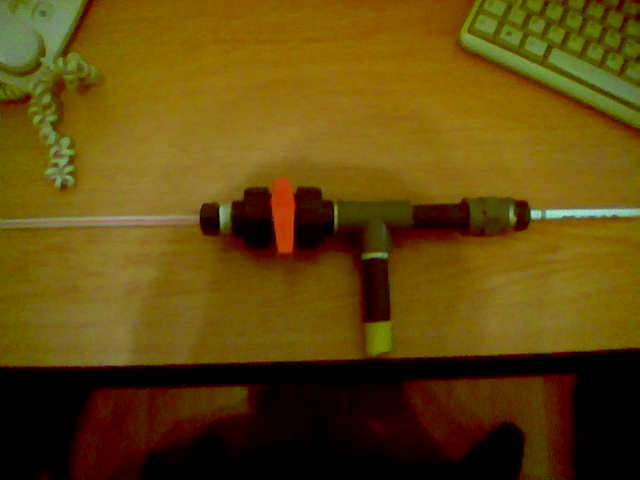

The whole gun with the balloon deflated.<br />To the left the barrel, to the right the pen I used as a stopper. You can use the straw for size comparism.
