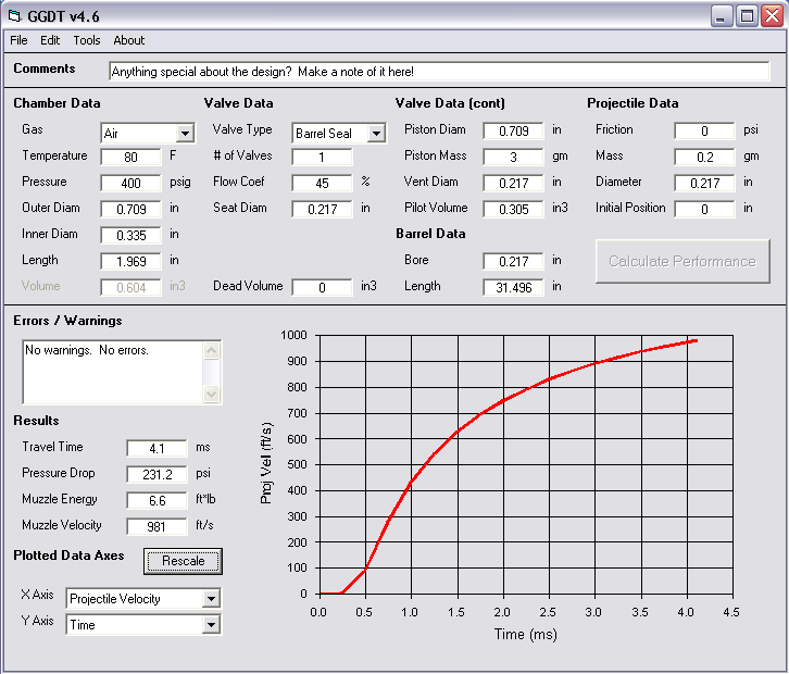

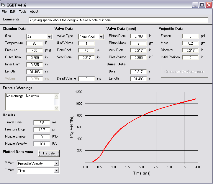

Easy. Have a look at these GGDT files of my next-gen Q-tip gun.
The first chamber has a length of a mere 5 centimeters, while the next has a length of 80. For 75 more centimeters of chamber, I get only 100 feet per second- it would be much less painstaking to mix up some NaOH + Al and use hydrogen, which bumps the fps up to 1400+ fps. Also, there's no way I could pump the larger chamber with my shock pump, and it would be extremely noisy, as opposed to the other which will have dropped the chamber pressure by 290+ psi, down to 100ish which will produce a much quieter report. In fact, the next chamber may get even smaller.
Just use the generic function to model a sprinkler valve. You may have a few issues with some numbers, but nothing too hard to work out.
For 75 centimeters more chamber, not a lot of benefit. In fact, I wouldn't even be able to get it up to pressure.
next gen q-tip gun long chamber.PNG (30.81 KiB) Viewed 4266 times
