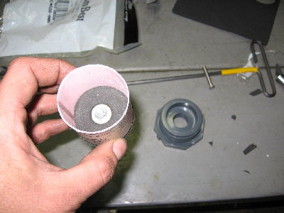

in my coaxiels I use a "cup" style piston... sealing face inside the cup, the cup can be lightweight(it's just for stability)... Here's a 2"piston that weighs less than an oz...
- t_inside_of_piston_145.jpg (24.36 KiB) Viewed 3654 times
