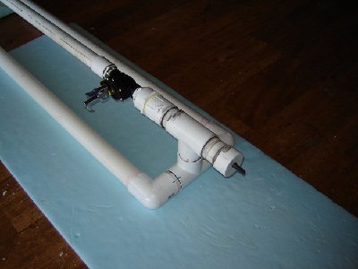

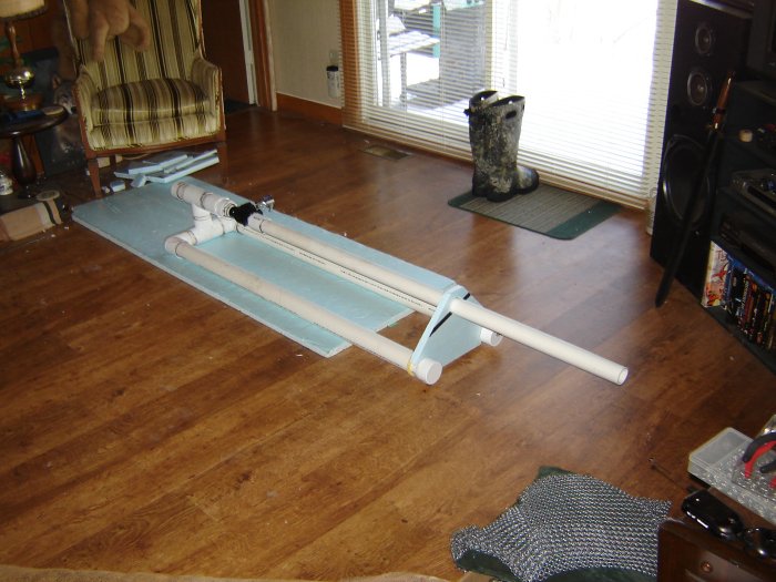

As the title says, this is my first cannon.
I built it to try and get a grasp of what's involved before moving up to a larger size of chamber and barrel. I have an "accomplice" who has almost unlimitied access to 600 psi rated 4", 6" & 8" heavy wall PVC, a dozen or so 2" sprinkler valves and a 100 acre farm to play on with the kind of beast one could build from those parts.
So here is what I built:
•Twin 2" x 48" sch40 280 psi PVC Chambers - with all the fittings it comes in at about 400 cubic inches.
•Barrel is 1.5" x 57" sch40 330 psi PVC
•1" Rainbird Sprinkler Valve
•Non Modified Blowgun
•Standard Tire Valve for filling
•Overall Length is 78"
The first thing I know people will think is that my Chamber:Barrel ratio (4:1) is well out or "norm" (1:1). You are 100% correct. According to GGDT - @ 80psi I am only running about 350 fps muzzle velocity. If I was to double thelength of the barrel, I could get much closer to 400-450 fps which would be an obvious improvement.
The logic behind my acceptance of a "lower performance" cannon is quite simple. Where I live (Ontario, Canada) a Firearm is described as:
•a barrelled weapon from which any shot, bullet or other projectile can be discharged and that is capable of causing serious bodily injury or death to a person
•A muzzle velocity of 152.4 meters (500 feet) per second or greater.
For that reason, I am keeping a fairly large safety zone between me & "the Law". I know I can run it up to 160 psi and still not exceed "the Law". Since I also collect real firearms, I don't want to risk losing the rest of my "toys". Better safe than sorry in this case.
Yes, it needs some paint and a proper piece of plywood cut for the Barrel Support, but I was in a hurry to test it out and some SM Blue was close at hand. It's a bit ghetto, but it's only temporary.
First "loaded" test was a 75 Gram Ice Slug at 15psi and 15 degrees barrel inclination. Result was 100 +/- feet down range.
Continued ramping up pressure and at 80 psi and 40 degree barrel inclination I achieved roughly 300 Yard down range.
Projectile had a lot of tumbling in the air so accuracy was not very good, but these were square cut cylinders of solid Ice so I wasn't expecting great accuracy - just a nice fit in the barrel with some acceptable mass for testing purposes.
All in all, I'm quite happy with the results.
My 10 yr old nephew was speechless with a grin from ear to ear :D
Cannon mk1
Cannon mk1
mk1 Valve
mk1 Valve

you used sch40 for all your fittings, and used a moded sprinkler valve on your first pneumatic, your accomplice has taught you well
My accomplice taught me nothing 8) I owe everything I know about Cannon Design - specifically how to mod Valves and which pipe is preferrable - to this site. Some great "How To's" here that were invaluable. The accomplice is a Construction Foreman who happens to have access to left over pipe from road jobs when they are installing new Water & Sewer lines. He heard of Pneumatic Cannons and saw a vid of "punkin chunkin" and said to himself "I've got that size pipe, but in PVC instead of the steel.". He then passed the idea on to me and I said I'd research the idea and build it for/with him if he gave me access to supplies for one of my own as well.
What I want to build for myself is a Breach Loading Coaxial (4" Barrel - 8" Chamber) using Twinned 2" sprinkler valves on a recoil absorbing turrent mount. (I should probably see if I can doodle up a sketch of it in Autodesk one of these days and get people's opinion)
I'm a "jack of all trades" kind of guy - Building my own Hotrod from the ground - up so Modding a Sprinkler valve isn't all that hard once you see a couple pictures and understand the theory of how they work.
I've been doing Home Repairs for 20 years, so "plumbing" isn't new to me. sch40 is fairly easy to work with as long as you don't let go of the connections when you first glue them together. They need about 30 seconds of good pressure if you want a full depth connection due to the slight (almost immeasurable) taper inside the fittings.
I know most people aren't used to this concept but I prefer to learn before I build. I spent a couple weeks reading and learning on this site before I bought any parts or supplies. Then I raided the local hardware store.

Looks like a good cannon. Great job for your first :) :) :)

I say you've done a mighty fine job with this, especially for a first. Have you considered a breech loader for it? A simple coupling breech loader can be made with just a small amount of effort.

Hubb wrote:I say you've done a mighty fine job with this, especially for a first. Have you considered a breech loader for it? A simple coupling breech loader can be made with just a small amount of effort.
Welcome to Spudfiles northern neighbor.
I thought about that, but for my First, I just wanted to get the fundamentals worked out.
The next step is to look into the various building design methods of breech loading and which will suit my purposes.
And thanks to all for the positive feedback!
