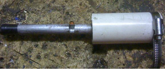

- this is the BFB its made out of pn12 pvc and has a drill press lathed piston made from some hard black plastic
- IMG_0041.JPG (28.88 KiB) Viewed 6252 times

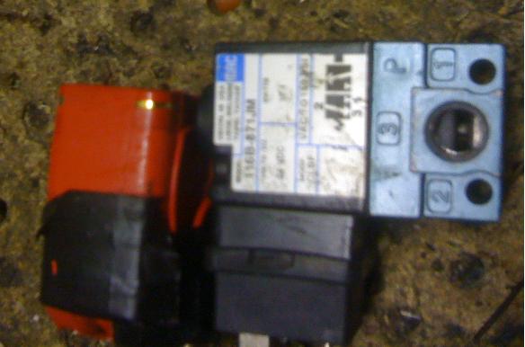

- this is the 3way valve
- IMG_0042.JPG (28.25 KiB) Viewed 6252 times

ok so you have a couple of 3 way valves.... are all of them solenoid valves??
if they are solenoid valves then you can use a simple electrical switch
when you press the button the solenoid will open the valve (piloting the gun)...
if you want to achieve full auto you need to use a simple switch that would send the signal through a thingy (555 timer/timer relay) that would convert that continuous signal into, let say, 5 short impulses per second...
so as long as the trigger is pressed it sends 5 short impulses to the solenoid and the solenoid opens and closes the valve 5 times per second as long as the trigger is pressed
you won't need two switches you just need one for the trigger and one to choose between semi auto (directly to the solenoid) and full auto (to the solenoid but leading through a 555 timer/timer relay)

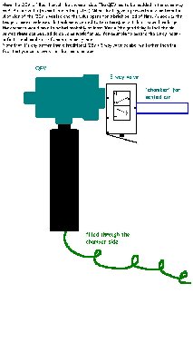

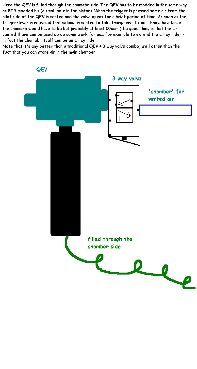

well you can find more info here -> http://www.spudfiles.com/forums/directi ... 20438.html
have a look at the pic there...that's basically all you need to get achieve semiauto with a QEV gun (ignore the loading mech there... all you need is a QEV gun + a 3 way NO valve)
Alternatively, as I said earlier in some thread, you can get the same result that BTB achieved on his shatterhand but without a hammer valve...
(that is multiple shots from air stored in the chamebr only... though it does not give you extra air or more shots in any way.... you just keep all air in the main chamber instead of having a separate tank, which might be useful but not in every case)
you'd have to mod the QEV to be filled from the chamber side... then attach a 3 way NC valve to the pilot side of the QEV and attach a small chamber for vented air.. in this way you would get good consistency
Though, I don't think that that would be simpler than just using the QEV + 3 way valve combo... you just have to buy a ready made product and attach it to the pilot side of the QEV... it's really that simple

well sort of... it would be possible to use air vented from the pilot side of the qev so the air cylinder should be attached to the small chamber that is supposed to keep that vented volume...
that's how one could build a gun similar to BTB's shatterhand but without a hammer valve... as I said earlier it is not the same thing as a simple QEV + 3 way valve combo
personally I am not a big fan of modding QEVs in order to fill them from the chamber side.
Lol I couldn't do that to my QEVs, I won't perforate their pistons.. they are way too young for that... as you can guess law is a bit different in the Netherlands

i tryed to pilot my homemade piston valve with a blowgun hammer valve it worked but wont re seal fully still goes shhhh, i think the barrel port isn't 100% level cut. i bought a cap gun a copyed the parts in metal and will use as the hammer ill post a pic later.
thanks for all the info poland, defiantly come to use on another project but i think its a bit essayer to make a hammer valve + qev and cheaper. my valve should be here in 7-10 warking days
