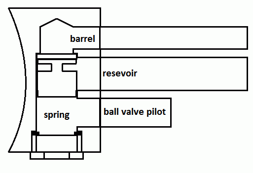

Will this work?
Jack_Hogg
Posts: 133
Joined: Tue Feb 20, 2007 7:56 am
Thu May 06, 2010 1:59 am
It will be made out of a solid peice of 30×60×150mm Aluminium
Tell me what you think

Jack_Hogg wrote:It will be made out of a solid peice of 30×60×150mm Aluminium
:shock:
Looks like a sound design, I imagine the tolerances will be tight so no reason why it shouldn't work very well.
Jack_Hogg
Posts: 133
Thu May 06, 2010 2:08 am
Ok, are there any things you would have changed? Like the size of the holes, or the end plug or something? I want it to be compact as pissible. A bulpup design.

Jack_Hogg wrote:I want it to be compact as pissible.
:D :D :D
Are the breech block dimensions to scale?
Jack_Hogg
Posts: 133
Thu May 06, 2010 2:16 am
:D
No. It's just a scetch. I still have no dimensions. Do you have suggestions on some dimensions?
EDIT
Barrel will be 12mm copper tube (10mm id) resevoir will be 1" 300mm pipenipple. Ballvalve will be ½

w-a-a-a-a-a-i-t a minute.
As it is the design won't work.
The piston can't de solid, otherwise there will be no place for the chamber pressure to open it once the pilot empties.

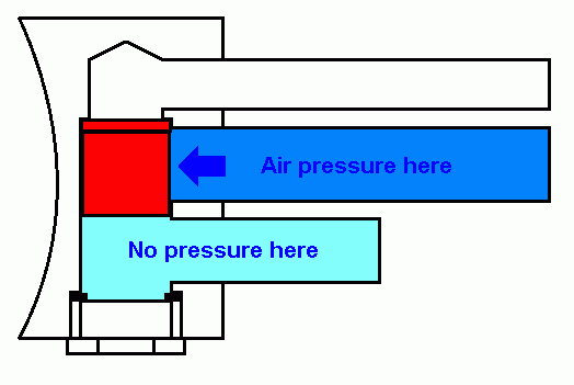

Jack_Hogg
Posts: 133
Thu May 06, 2010 2:44 am
Hmm I really have a hard time understanding this..
The pressure behind the piston is equal to the chamber pressure. Once the pressure is released behind the piston, the piston will move down am I right?
40BAR
Proud member of the Dutch Spud Clan!
Thu May 06, 2010 2:59 am
Look at the diagram, once you empty the pilot, what force is going to open the piston?

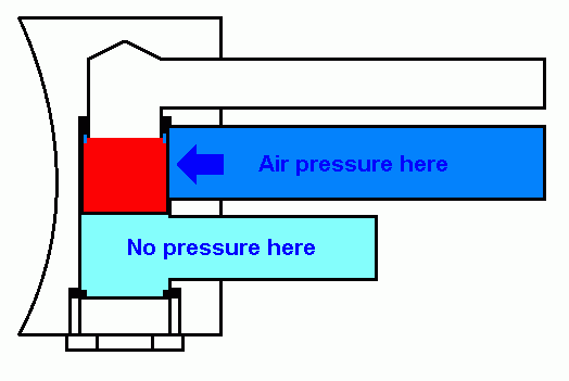

Jack_Hogg
Posts: 133
Thu May 06, 2010 3:20 am
Now I get it! Thanks! :)
EDIT:
I placed the ¾" tap in the middle of the piece. Will the sides hold 60bar?
It's about 1,5mm on each side
EDIT #2
I made a scetch of the dimentions. What do you think?

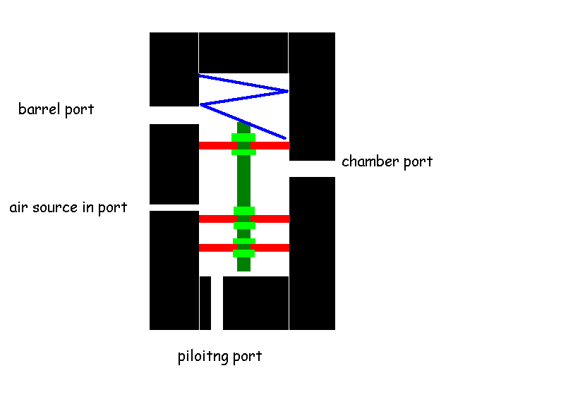

may I suggest building a spool valve design ??
in this way you could pilot the valve using lower pressures
of course you can have all the ports on one side of the block...
positive pressure valve.PNG (16.38 KiB) Viewed 4083 times

This design can most certanly work. What the drawing does not show properly is the location of the barrel seal and it's diameter. If the seal is on the OD of the piston, then absolutely it won't work unless converted to a manually opened QDV. There will be no force to open the piston once the pilot is vented.
If there is no seal from the chamber forward so air pressure is on part of the face of the piston and the seal is at the end of the barrel, then there will be pressure on the piston face to open it. The big problem is there is not enough space to keep this pressure on the face of the piston so when it cracks and the piston face pressure vanishes out the barrel, it will stop opening. A piston with a step down in size to permit air into the piston face area will work fine.
Edit, edited the drawing to show the change.
Extending the valve seat closer to the air chamber would improve the performance.
Edited again to show the extended valve seat which results in a shorter ligher piston and better flow to the face of the piston when it opens. All good things.
Modification to show new seal area on the barrel. It is not able to have pressure to open.
2nd image edit to move the valve seat and show the face of the piston with pressure to open it.
