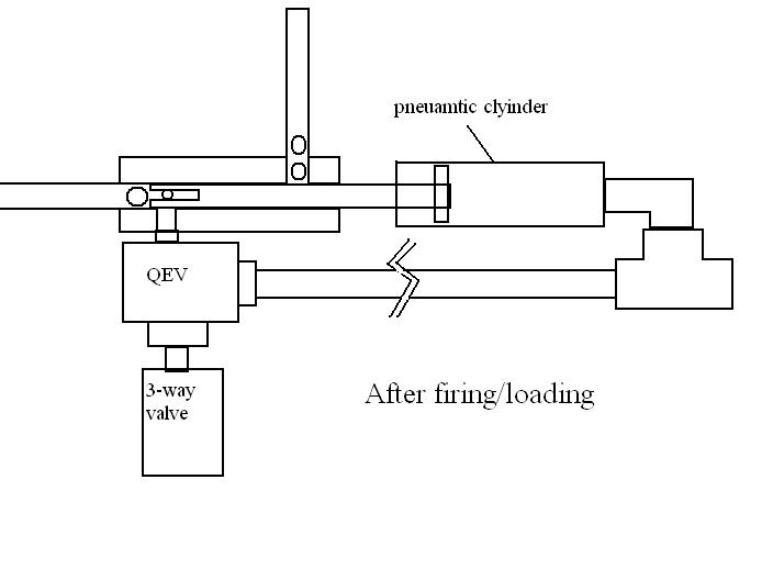

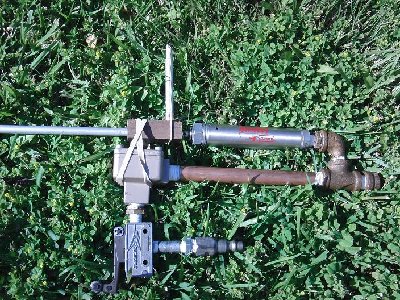

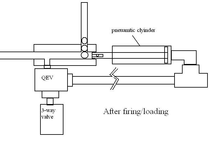

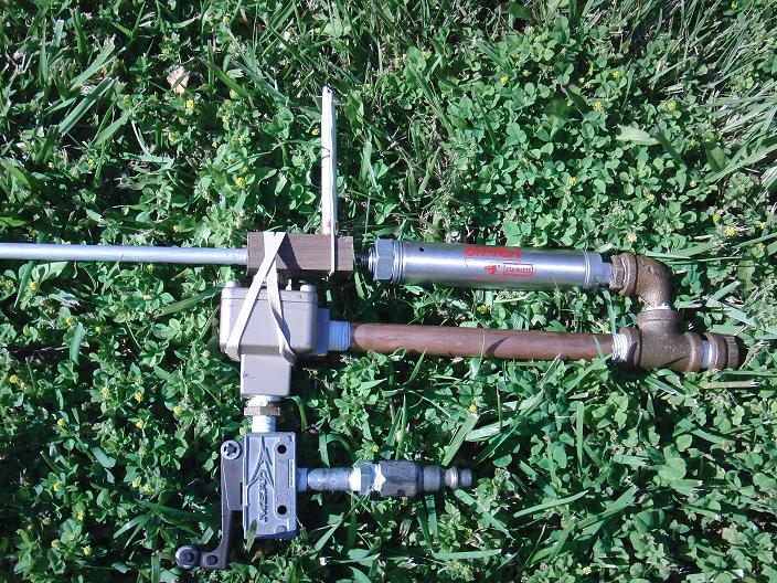

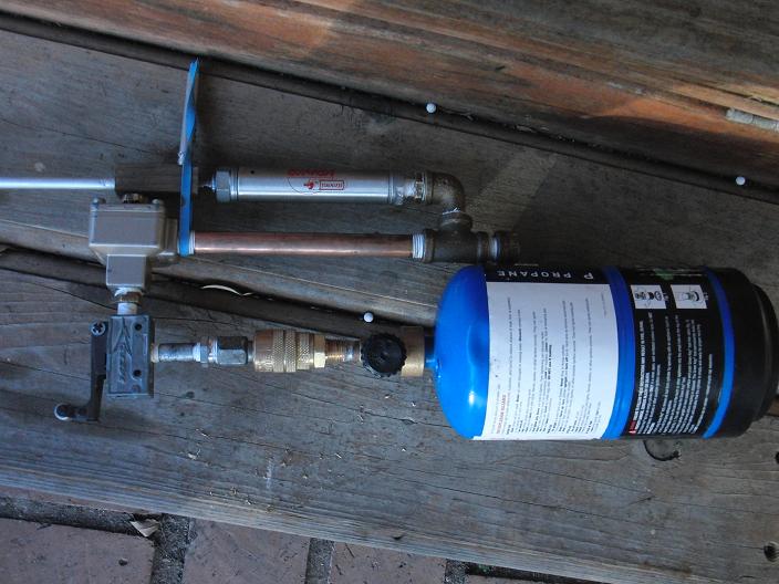

Hey guys, been a while since Ive posted on here, Ive been playing with my shopsmith making pens and such, but I while I was browsing ebay for pen kits, I came across a deal I couldnt pass up, a pneumatic cylinder with 1.5" stroke for $2.00.
So I ordered it and while I was waiting for it to arrive a designed a modification to one of my near semi-auto airsoft guns that uses a 3-way dcv and a 1/4" qev. My first attempt failed miserably because I had the cylinder running parallel to my barrel and below it, this created to much torque when it tried to move the breach and ended up breaking about 6" of my barrel.

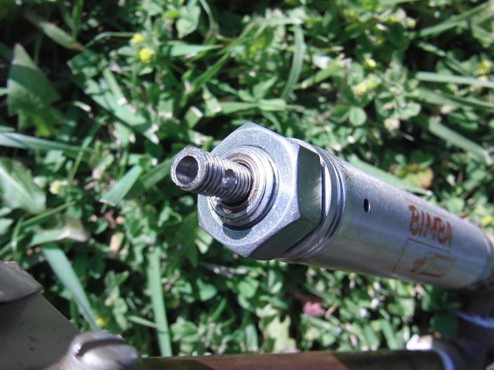

I realized the piston had to move inline with the barrel, and it just so happend the shaft of my piston was a perfect fit into my 6mm aluminum barrel so I decided to use the shaft itself as a bolt. The only problem now was how to let air flow from the qev that was perpendicular to the barrel. My solution was to bore out about a half inch of the front of the pistons shaft and drill 3 holes to allow air to flow through it and out the barrel.
This design works beautifully and was very easy to build, I just drilled a couple holes in a block of walnut and used that as the structure to hold the aluminum tubes together.
Its not much to look at, just a couple of steel and brass fittings but it definitely is effective, when testing the bolt in my garage I accidentally shot an airsoft bb into a cardboard box of bear and broke a bottle. :shock:
High speed video and more pictures to come, I got rid of the rubberbands now, they were just for preliminary testing.
where I bored out the piston shaft and drilled holes.
after loading.jpg (23.52 KiB) Viewed 12292 times
after firing.jpg (23.31 KiB) Viewed 12292 times
the propane tank attachment so I can fire anywhere.

I admire everything about this gun. Excellent work. The bored cylinder was a smart solution and it reminds me of a problem I had to work around in a very similar situation long ago. Only difference was that I sort of sharpened the rod end to a pencil point instead.

@pvcarsenal I was considering a pencil point thing too but I though it might push bbs back up into the mag.

Looks good. Nice to see some "gas-operated" semi-automatics around...

The cylinder is a Bimba, the valve is mead mv20 3-way valve.
cylinder: http://cgi.ebay.com/Bimba-Single-Acting ... 2a061bafb0
and yes you could probably go full auto in small calibres, the spring retracts very quickly, I'll try to get a highspeed of the loading mech.

the threads are just standard 1/8" same with the 3-way valve.
I added a vid showing just how quickly the cylinder opens and closes.

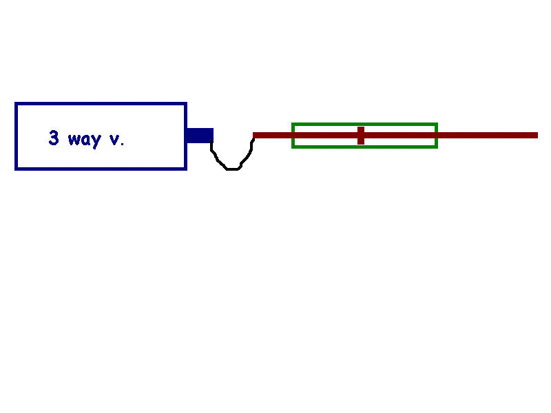

Apart from what pvc_arsenal has said... psycix's pop-off experiment has proved that only some air (NOT all) in the chamber is exhausted... this means two things:
1. decrease in performance
2. the air cylinder won't retract
you could improvise and build a circuit with a 3 way that would switch from on position to the other... but that isn't much simpler than the two options that I posted in my previous post
ohh I just realised that there is a simpler way...
I mean...in theory it is simpler but in real life it might be a bit difficult to implement it...
It really is very simple... I'll add a pic
for simplicity sake this pic shows just the 3 way (but it can be a 5 way) and the air cylinder (this one has two rods - for simplicity)...<br /><br />as the cylinder retracts the rod hits the stem of the valve and it switches it from one position to the other<br /><br />at that moment air rushes to the air cylinder and it starts extending.... <br /><br />the stem and the rod are connected with a steel wire that pulls the stem back to its original position when the air cylinder is fully extended<br /><br />the cycle repeats
the cycle repeats
