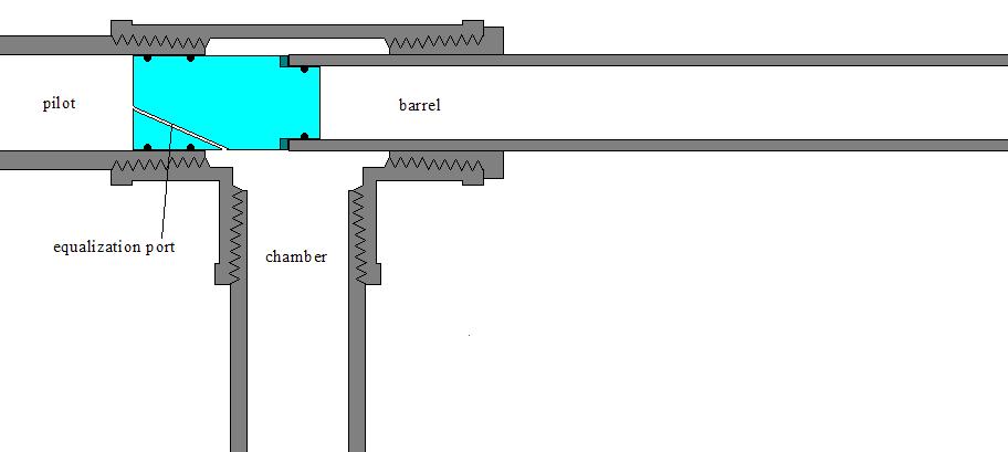

At the pressure you are talking about, it may pay to figure the force on the piston, the force on the piston seat, the area of the piston seat, and the punch through force required for your seal material.Northir wrote: i may have to look into a Brass nipple then, the one i have isnt entirely smooth,
In other words, at 500 PSI on a 2 inch piston, it will work like a hydraulic press on a rubber cutting punch most of the time. You may want to rethink your materials for the pressure involved. A wider valve seat is highly recommended unless you are planning on punching GB diameter rubber wheels out of your piston face.

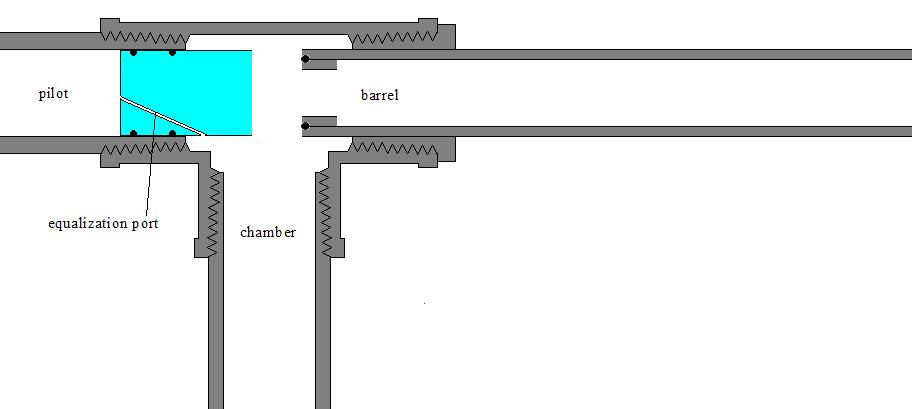

I did that on one of my earlier launchers. Between 80-100 PSI the pressure on the barrel seal o rings tend to lift out of the groove and as the piston exits the barrel, the o ring in a vain attempt to maintain contact with the barrel wall due to air pressure simply removes the o ring and launches it. This is the primary reason my current cannon has bars extending past the barrel seal. It is there to keep the o ring in place.
As an alternative, ( this is why it is there by the way ) use a wide valve seat like is used in the Mouse Musket. A coupler is placed on the outside of the barrel and both are cut even. This provides a larger surface area for the valve to sit on instead of a narrow edge. On the Mouse Musket, the O ring is recessed behind a lip to prevent the air from lifting it out of the groove. It is also embedded in caulk.
On paper the above looks good, but in use they tend to launch the o ring out the barrel. That was one of my many early failures and a learning experience. Many of these early learning experiences led to the design of the Mouse Musket.

Edit, added a view of the valve seat in real life. 1 inch barrel, 1 inch coupling on the outside of the barrel with an o ring embedded in a hand carved groove between them. Tested to 150 PSI. Piston OD is 1.5 inch.

- Recommended mod for a larger area valve seat. The o ring is embedded to prevent launching it. A flat traditional piston seal could be used instead of a valve seat o ring.
- 500psi_piston_valve.jpg (22.63 KiB) Viewed 4994 times

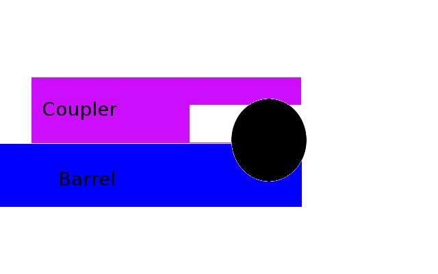

Cool, I might have to try it. What did you use to hand-grind the groove between the coupling and pipe seat?
- Technician1002
- Posts: 5189
I used a small round file to cut a groove in the outside of the barrel while the barrel was longer. I carved out the inside end of a coupler with a pocketknife and cut the coupler in half. I slid the half coupler on the barrel to check progress often and stopped when it fit over the o ring on the barrel. The coupler position was marked. The o ring was removed, then the coupler was slid back. The barrel was cut using the coupler as guide. The coupler was glued in position. Caulk was added so air could no lift the ring. The ring was stuffed in (narrow gap into the groove) and set to cure as mentioned after wiping off caulk that squished out.
The end of the barrel is about the full diameter where it was cut. Behind the end it is thinner for the groove. Only 2/3rds of the ring thickness shows. Part of the ring is covered by the barrel as shown in my drawing. I did not want any way for that ring to blow out.
Edit added drawing of the cross section of the Mouse Musket seal to show the groove on the outside of rhe barrel.

- O ring in the mouse musket
- musketseal.jpg (10.27 KiB) Viewed 4904 times
