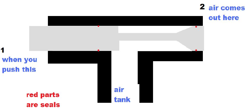

OK, so um...can that be made into something as small as...a quarter of a pencil?Assuming I'm getting this right, the Schrader valve goes into the lyre cap, where air is the pumped in, the hammer is screwed into the chamber at the right side. When once pushes the rod , the hammer will go left and ir will go out from the outlet on top of the chamber, the spring will then return the hammer to its normal position. Is there a way, to make the air go left? And on a indirect suggestion from a poster above, a picture should be worth a thousand words, I'll draw a quick one on Microsoft paint and upload it.

Hopefully this helps, oh, and I'll get the loading figured out, but right now, its for a bolt loading one shot

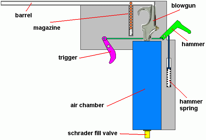

Here's one way it could work, using a standard blowgun as a valve.

Well, that could work, but I'm in high school, I can't just get any parts I want ( I'm job-less), and except for the hammer valve, I got everything worked out, so is my design going to work? If not, I'll have to use yours, but it's gonna be a lot bigger, I'll post up the full design later
