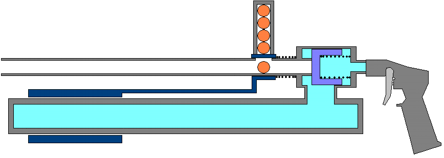

As to your design, I would shy away from pressurising for a secondary chamber, unless it's a regulated HPA source, because you'd get very inconsistent power. It would be a better idea to have a spring loaded ball valve and a momentary pilot. Here's how I would make it:

Yeah, That looks like it would work. Another thing I have thought about woud be a double barrelled launcher, with a seperate chamber for each barrel.
