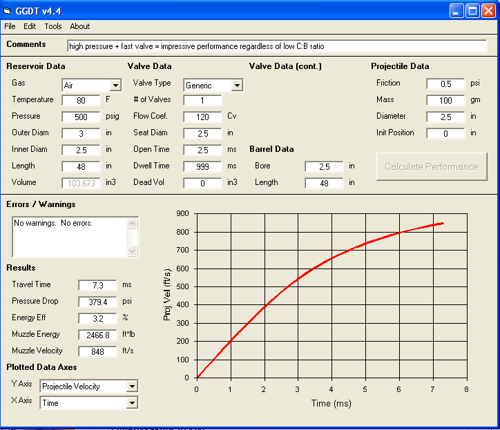

Gun Freak wrote:You must have read it wrong... Performance probably wont be great in my opinion.
It depends on the other launcher parameters - if you have a burst disk, long barrel and high pressure, performance will be quite impressive even with a 0.2 C:B ratio.

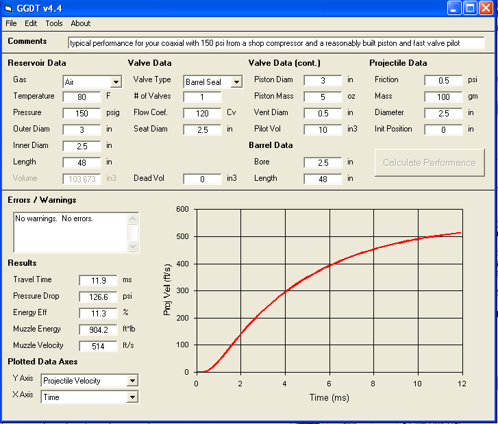

Thanks Jack, I would play with GGDT but I have no idea how to... And Gun Freak I am capable of reading, and it said "Suggestively, the optimal C:B ratio for pneumatic guns, as predicted by GGDT are in the vicinity of 0.2~0.3" Also Jack, once I get some rough plans drawn up I'll post a pic.
Wed Jul 13, 2011 11:22 am
Jabingo19 wrote:Thanks Jack, I would play with GGDT but I have no idea how to...
Download it and learn, it's worth the effort.
Here's a more realistic model of your coaxial, about as much power a 3 round burst from a 9mm submachinegun ;)
