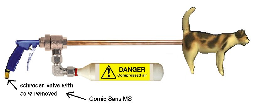

Here's a compromise solution, fit a schrader valve to the blowgun and remove the core. This way, you can fill through the pilot (provided the blowgun is held open) and when you pilot, the flow isn't really restricted. You can improve it further by drilling out the schrader to 4.5mm
Postal cat silencer optional :)
Goats spudz
Posts: 458
Joined: Tue Aug 02, 2011 12:31 pm
Wed Aug 03, 2011 12:23 pm
jackssmirkingrevenge wrote:
aEx155 wrote:The only reason I can think of not to do this is because it would increase the pilot volume. (I don't know how good a reason that is though)
WoW! i didnt think of that thanks :D

@ jack, not what I was thinking exacly, but I like this idea better! When you get to the desired pressure you want, you would just let off of the blow gun trigger and this would close the schrader, correct??? Nice!!!! 8) I like the pussy cat silencer as well!!! :wink:
Go Bruins!!!!
Wed Aug 03, 2011 12:49 pm
mattyzip77 wrote:you would just let off of the blow gun trigger and this would close the schrader, correct?
Not exactly, the schrader in this case is not acting as a valve because the core is removed, all it is doing is providing a connection point with your pump or compressor - but yes, hold the blowgun open until desired chamber pressure is reached, release blowgun, remove pressure source, ready to fire.

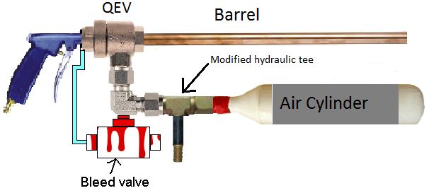

Could you avoid modding the valve by having a bleed valve between the HPA tank and a small chamber? The chamber would fill to the PSI of the tank then when fired would begin to slowly refill via the bleed valve. Because it would be at a low pressure for an amount of time would it be sufficient to let the QEV's piston return?

No QEV pistons are check valved so even with a spring it wouldn't work.

Gun Freak wrote:No QEV pistons are check valved so even with a spring it wouldn't work.
Technically it would, it's a complicated equivalent on poking an equalisation hole in the QEV diaphragm.

Gun Freak
Lieutenant 5
Lieutenant 5
Posts: 4971
Wed Aug 03, 2011 11:11 pm
That's way overcomplicated :D
