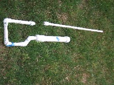

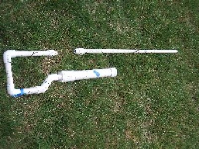

This is a paintball sniper rifle that I made out of random parts I had lying around. I don't have a paint job on it yet but most likely it will be either that ugly brown on all my launchers or hot pink. The chamber is 1.5" and the barrel is SDR-13.5. The thin wall half inch fits PBs so perfectly I can shoot the splat of a paintball with another PB. The barrel is 38" long. This uses a 3/4" sprinkler or one of my homemade valves. This thing chronied at 571 fps when I took it paintballing. Too bad the guy didn't let me use it.... hmmm.... They don't make you check speed when you're only playing with your friends :twisted:
CB ratio= 1.5:1
