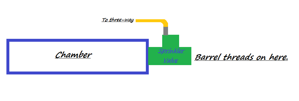

See, if you tell me a sprinkler vavle setup would work, then i am all good. I mean, I'm only shooting shirts, and only 75-150 feet. Trying to avoid a bit of the blatant experimental stage. Would a sprinkler valve cannon work?
I had thought about using 2 solenoid valves, a normal closed (Sprinker) and a normal open. The idea being that when the trigger is pressed the sprinkler vavle opens and releases the air to fire the tshirt, while the other valve closes off the supply air flow. When the trigger is released, the barrel pressure drope as the solenoid valce closes, and the other opens repressurizing the firing chamber.

That's a little more complicated than it needs to be. I think you can use a modified sprinkler valve and a three way valve to get the effect you want. The image should give you an idea on what you would be looking at. You connect your air supply to the three-way spool valve and connect the valve to the pilot of the sprinkler valve. when the valve button is released the air supply will fill the pilot and chamber. When you press that button, the air supply is shut off while simultaneously opening the pilot exhaust thus opening the sprinkler valve. There's plenty of resources on how to do the modding of the sprinkler valve to work with.

I was looking at what another member had done using an industrial QEV and a Slide Valve to create a kind of semi automatic action. Would a QEV offer any benefits over a sprinkler valve?

I follow how the 3 way valve works. one position makes supply air go in, seond position allows pilot air out. And just so i am clear, the pilot port of the sprinkler valve would also be my filling port?Mr.Tallahassee wrote:That's a little more complicated than it needs to be. I think you can use a modified sprinkler valve and a three way valve to get the effect you want. The image should give you an idea on what you would be looking at. You connect your air supply to the three-way spool valve and connect the valve to the pilot of the sprinkler valve. when the valve button is released the air supply will fill the pilot and chamber. When you press that button, the air supply is shut off while simultaneously opening the pilot exhaust thus opening the sprinkler valve. There's plenty of resources on how to do the modding of the sprinkler valve to work with.

Say i wanted to use a QEV instead (for form factor) of the Sprinkler Valve.
So, Supply Bottle -> 3-way (I'd still like a solenoid here for trigger placement)
3 has Environment port, and other port goes to QEV Pilot Port (Which is also the filling port correct?)
QEV acts just like sprinkler valve as far as number of valves and direction of airflow.
Trigger 3 way solenoid valve to vent the pilot of the QEV to the environment. The QEV opens between its chamber and the barrel.
I hope i am 1) correct in my thinking, and 2)understandable.

a qev s 100 times better than a sprinkler valve and about the same price and needs no modification. I wouuld go this route with a push button valve to keep your size small and compact. Also use the edit button so you dont double and triple post.

What diameter QEV would I be looking for?

Spudbucks are totally useless so no need to rack them up lol. A 3/4 inch or 1 inch would be fine considering you want to keep the size compact.

Ok, so i am looking for a QEV, and 3-way solenoid, and fittings for use of a CO2 Bottle.
Go for a 3/4" QEV, it should give you decent flow for the purposes of launching a T-shirt. Go for as small a diameter barrel as possible too, you lose less pressure due to expansion and, initially at least, the T-shirt "projectile" will lose velocity at a lower rate, and therefore should go further.
