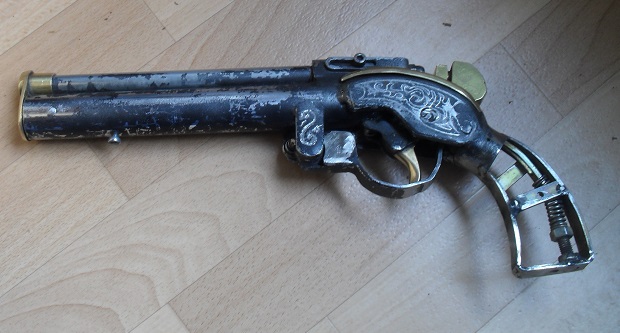

Well...as I announced earlier, my pump-pneumatic has been cut short and given a new life as a PCP pistol.
It's not yet finished ( looks like it was salvaged from a bombcrater...)
but fully functional..
I decided to keep it a single shot repeater.
The Girandoni style sidemounted magazine was removed.
I need to acces the breech in case of a jam and I didn't like the look of the tube mag.
I could do a cilinder or revolver style but I really don't think it'll look right.
I'd have to place the cilinder too far forward for it to work.
It feels like a desperate attempt to make it look like a firearm...wich is completely unnessecary..
On top of that...I think the lever action was kinda smart and I wouldn't like to destroy it.
I'd rather start all over and keep this one like it is.

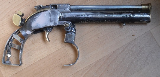

Swinging open the triggerguard exposes the breech...I just pop in a roundball from my pocket.Works well.
The rough unfinished look gives you guys plenty to comment about , I'm sure... :wink:

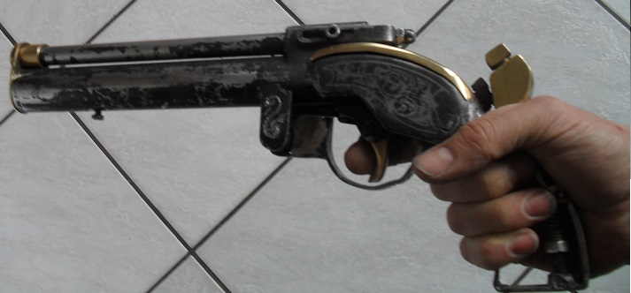

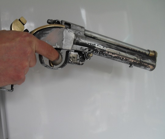

is the Trigger pull on that thing hard??
On the contrary.It's supersmooth and the hammer is easy to pull.
I can cock it singlehandedly, with my thumb.

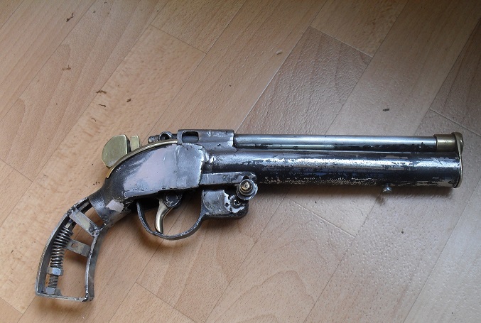

You guys got to me..I decided to do some work on it.
Before my fix yesterday the main tube was cut short, but not very straight.. :oops: So I fixed that.
Another thing I hated was the gap between the sideplates and the pressuretube.
I decided to fill that up.
I want the structure and design of the gun to look clean, the finish can be rough though..like a well made -but worn afterwards- kinda look.
I finished bondo, sanding and paint yesterday.
Unfortunately the clearcoat I used dissolved the paint partially so I´ll have to redo that, hopefully today.
