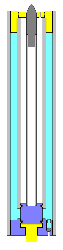

Thinking about it, if the whole system is airtight, I doubt the cabbot (lol) is actually in contact with the dart after a couple of cm of travel, because of the internal pressure generated.No chipping and deforming...
The pressure-buildup would probably just help to eject the arrow...
reducing the diameter of the tail would make sure it does.
Just thinking aloud here, for a pneumatic the cabbot could be a QDV piston...
- cabbotdartcart.PNG (7.76 KiB) Viewed 6956 times
