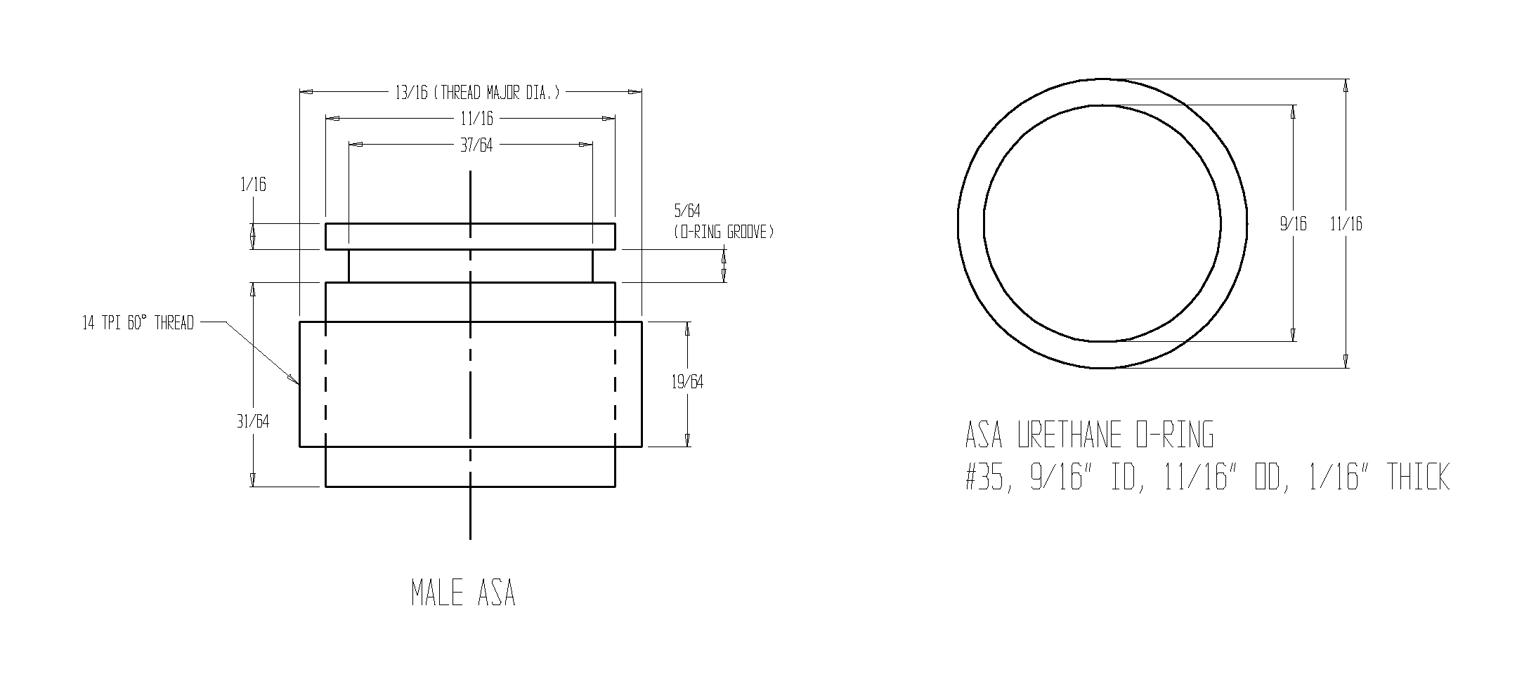

Oh, in that case:
You can also use a 1/2" NPS (straight pipe thread) thread not NPT (tapered pipe thread). A paintball ASA thread is .825-14 NGO. A diagram is below.
1/2" BSP has the same thread diameter (thread major diameter: .825 inch) but a slightly different thread angle (55 degrees).
1/2" NPS has the same thread angle (60 degrees) but a slightly different thread diameter (thread major diameter: .826 inch).
