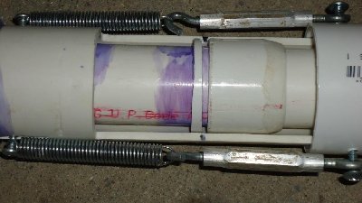

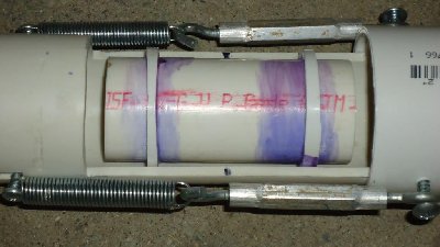

Oh, ok. Can you snap a good picture of one of your cartridges?
CannonCreations
Posts: 57
Joined: Fri Sep 02, 2011 9:30 am
Sat Aug 10, 2013 2:49 pm
ok, here is a picture of the cartridge in the cannon
This is a picture of the cartridge in the barrel
here is a picture of the cartridge with the barrel locked, part of the cartridge is actually hidden inside the 2" sleeve

Blitz

Sat Aug 10, 2013 2:50 pm
Not showin' up. :(

Sat Aug 10, 2013 2:51 pm
yeah sorry had to fix it

Sat Aug 10, 2013 2:53 pm
Ah ok, there we go. I see what you mean now.
