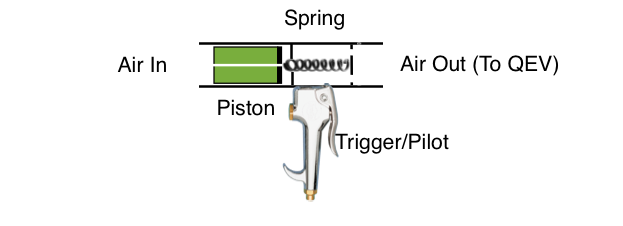

What it was supposed to do, was work like a slide valve in the fact that it should shut off the air source while piloting. I built one, and it kind of works, but not really any better than just putting a flow restrictor in place behind the pilot.
If I make a cast epoxy qev piston, and spring behind it, could I chamber fill and pilot from behind with like a blowgun or something simmer?

1nxtmonster wrote:If I make a cast epoxy qev piston, and spring behind it, could I chamber fill and pilot from behind with like a blowgun or something simmer?
Pretty much what I did here using a schrader as a pilot.

Yep, pretty much that. I'm making a pilot valve like this:

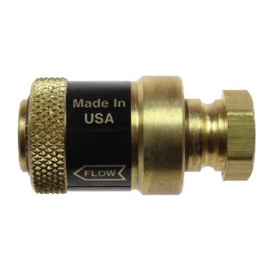

**Edit** Under pressure, the slide valve doesn't want to move. The more pressure, the harder it is to move. I am using this slide valve:
Any ideas?

thats how it works. look at my build http://www.spudfiles.com/pneumatic-cann ... 25393.html
basically the same idea on my pilot, just machined by me. At 400 psi it's fairly hard to pull it back. I use to lube it with silicon oil for a easier pull
