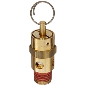

The problem with your little spring loaded ball setup is that it doesn't pop, it just leaks. A true pop-off valve uses a piston which when moved slightly, exposes a shoulder to pressure which moves violently to dump air. You can see it in a home brewed pop-off I had made using a syringe and liberal quantities of epoxy:
Try using one of these as a pilot:

I picked up a pressure relief valve, rated for 140 psi. I put in a lighter spring and here is the result;
It's a lot louder than the video suggests.
