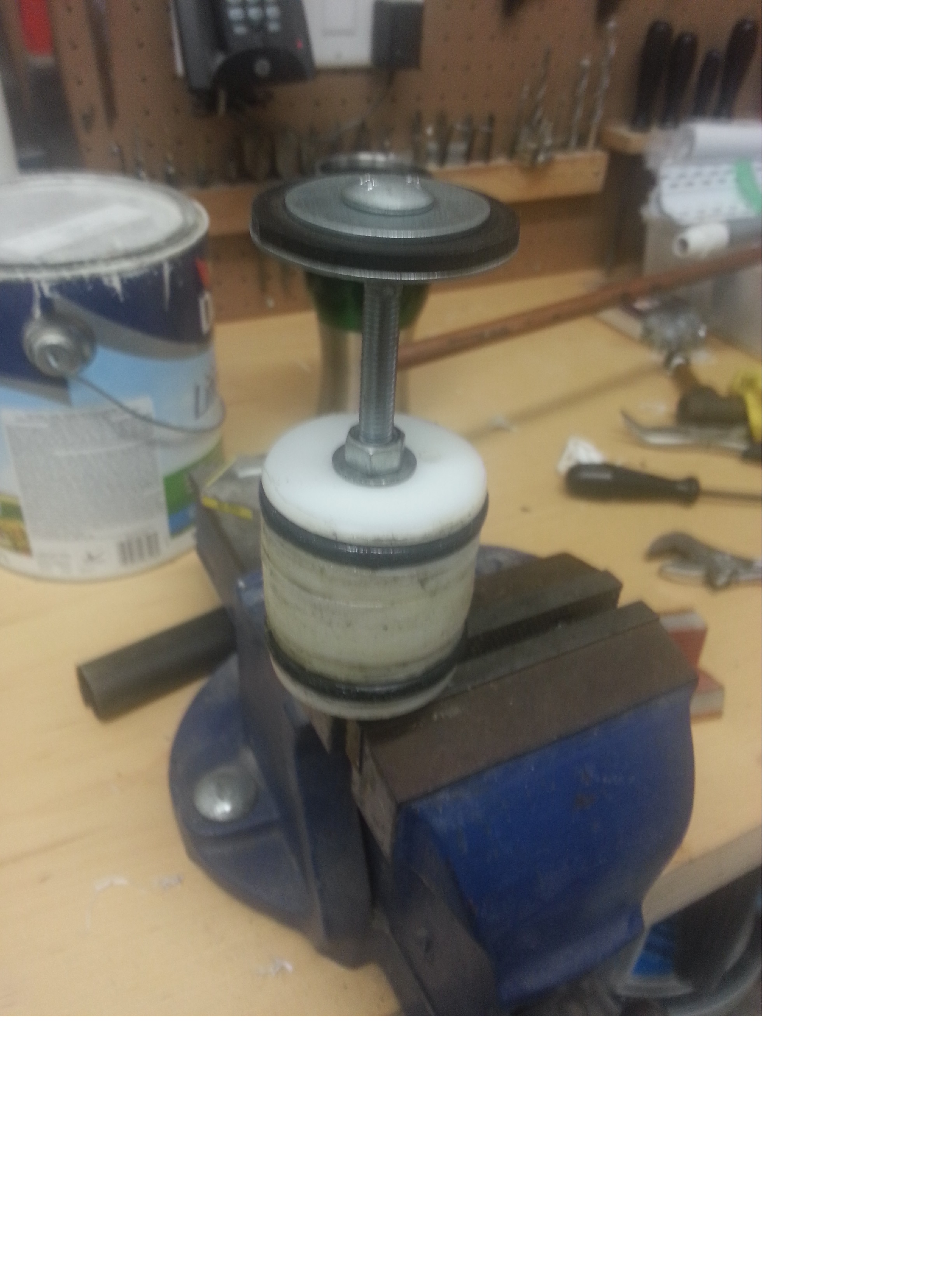

Piston needs a minor fix as it seems I've got metal on metal near the sealing face so there's a tiny leak from that.
Piston for the 1.5" cannon

It seems like the sprinkler valve top is leaking as I get past 50psi, a result of a weak top and cheap epoxy. I'm thinking one of two options...
1-lather on the rest of the epoxy I have over the top of the valve
Probably worth trying even if it is a waste of epoxy
2-move the qev from the smaller cannon to the bigger one
I have a 2"x1/4" reducing bushing kicking around so I could keep the pilot volume for the qev pretty small, but would I be losing too much efficiency in doing so?
Eliminating the sprinkler valve would up the max pressure for the set-up, but I'm mostly wondering if my qev solution will work, and at the same time I'd probably have to totally change the smaller cannon to be blow gun operated.
Thanks!!!
Re: .5" and 1.5" Piston Valve Cannons
Posted: Mon Mar 03, 2014 4:50 pm
by jackssmirkingrevenge
Trauts wrote:I'm mostly wondering if my qev solution will work
Short answer is yes, you have an o-ringed piston so a super high flow pilot is not critical.
