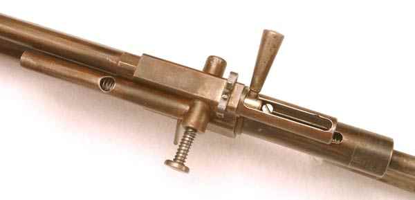

I've been studing this photo of a bolt-action PCP airgun for a while. Take a look , many parts and quite complicated but beautiful.

Thanks for that link, replacing the compression fitting with a T will certainly solve the mag inlet placement issues.
I guess no known answer on the other questions, but i can disregard the bolt action queries for now as they are no longer pertinent.
That mechanism sure looks beautiful, but in my 30 second inspection I couldn't ascertain how it functioned. Is that from a thread or webpage with more information?
Wed Mar 26, 2014 5:56 am
hydrolyzer wrote:That mechanism sure looks beautiful, but in my 30 second inspection I couldn't ascertain how it functioned. Is that from a thread or webpage with more information?
This was my interpretation:
The bolt is pulled back, exposing the magazine port and simultaneously cocking the hammer that is caught by the trigger. The pin on the magazine is pushed, introducing a single projectile into the breech, then the bolt is pushed forward again and locked in place.
For firing, the trigger is pulled, releasing the hammer which strikes the valve stem, momentarily opening the valve which allows a burst of air to move through the transfer port and propel the projectile out of the barrel. The cycle can then be repeated.

Now I know that I can get one of those lines and adapt it directly to my pressure washer valve.
That bolt action diagram makes sense, and I think if I develop the desire for something more challenging than my current project that will definitely be on the shortlist.
