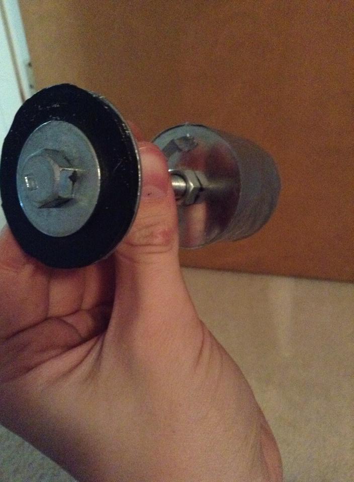

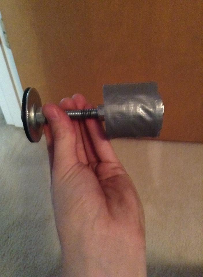

Piston-about 4 3/4''
2'' pipe the piston rides in-about 4 3/4'' (with current crappy back stop)
Space between sealing face and pipe-about 1''
