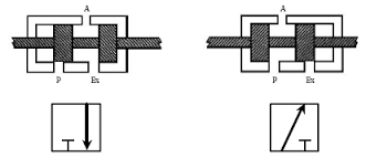

Is the diagram below hat I need? If so anyone know a source of cheap large bore versions? Found a 3/8" port one on EBay, just concerns me my supposedly 3/4" QEV from eBay was far smaller

Would this worm in place of slide valve? My main concern is that I read on here someone had to modify theirs to allow it to act like a qev

what type of valve? 2 position 3 way?

Slide valve is a 3/2 valve, so you need a 3/2 valve to replace it like in the diagrams in your post.
Not sure if you can modify those to work like QEV, but why you don't use the 3/2 valve to pilot/fill a larger QEV ?

Yep, the plan was to use a 3/2 in place of the slide valve, this would function in 1 position to fill the chamber on the gun and then when in other position use as a pilot for the QEV to fire it.

Normal 3/2 Directional control valve will work. They have one input, one output for filling, and one for exhaust (pilot).Ianbuckwell wrote:Yep, the plan was to use a 3/2 in place of the slide valve, this would function in 1 position to fill the chamber on the gun and then when in other position use as a pilot for the QEV to fire it.
BTW forgot to say thanks for your help
Anyone know about needing to modifying some, something like they have 2 inputs and 1 out ? Thanks
So normal position fills your chamber from the pilot side of QEV and other position stops filling and pilots the QEV.
If you have problems finding a suitable 3/2 valve, you can also search for 4/2 valves too, they work the same way if you plug one outlet of it. I have used both.
