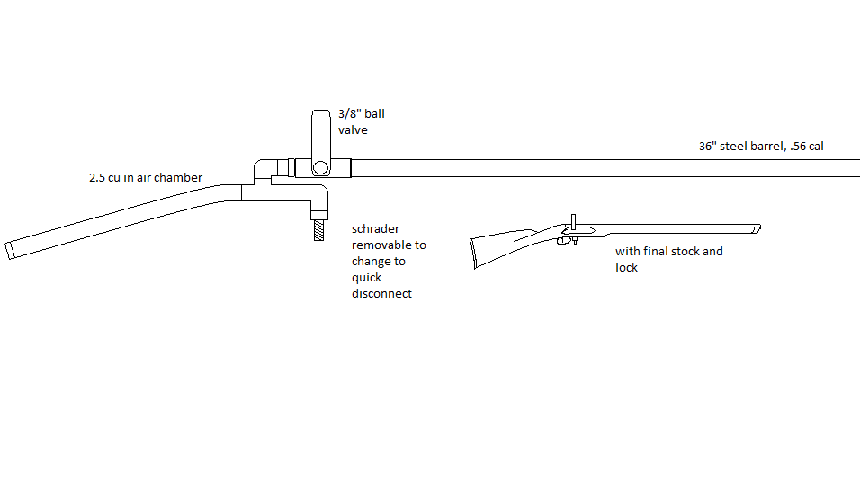

Anyway, simple design with only 4 vital components
-36" long, .56 cal barrel
-13" long, 1/2" copper reservoir
-3/8" ball valve
-Lock aka mechanism which will allow the ball valve to snap open with the pull of a trigger
airgun design.png (9.35 KiB) Viewed 12864 times

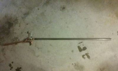

I don't know if this is the optimal barrel/chamber ratio, however I want to keep the chamber on the small side while still using the long barrel to it's fullest. I've tested it already and the results are very exciting, I used an old bike pump and with just 2 good pumps (and using my hands to open the valve) I was able to shoot a 1/2" ball bearing faster than a slingshot with powerful flat bands. :shock:

What I have so far, chamber, valve, and barrel.

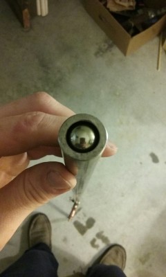

The barrel is seamless steel pipe I found online, with a 1/2" steel ball bearing the fit is so exact it has an almost air tight fit in the barrel. Even the thinnest of patching will cause it to be very difficult to get down the barrel.

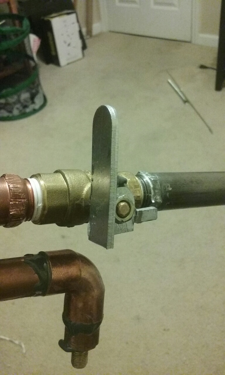

Today's challenge was trying to turn the ball valve handle into a faux flintlock frizzen
Which is supposed to emulate the flat L-shaped piece here
The purpose of the frizzen on a real gun is to give the flint a steel surface to scrape and spark against, the purpose of my frizzen is to be a surface for the hammer to collide with at high speed which will turn the valve faster than a spring alone, it's comparable to pushing a door open vs kicking it open. Right now it's just epoxied together, I don't expect the epoxy to hold, especially since this piece will be subject to a lot of stress, I will braze or solder this eventually.
