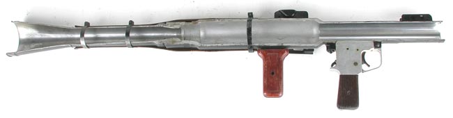

Venturi nozzle: This idea i got from the Carl Gustav recoilless rifle; It has a big bore barrel with a venturi breach at the rear to create just enough back pressure to negate the recoil from firing the shell.
A piston valve would be fitted with a 90° elbow piece that goes to a T fitting. The rear side would have a union fitting with a washer inside of it to reduce airflow. That union fitting would go to an adapter piece at least twice the size of the T fitting to create the venturi effect. The front side of the T fitting would connect to the barrel and hold the projectile.
Whilst i do think this one might work, i doubt that gas powered cannons can provide the amount of gas needed to make the venturi system work. Maybe this would work on a powerful hybrid?

Not really practical, you would literally need a chamber about 4-5 times larger in volume before sufficient air was available for this to happen.Venturi nozzle: This idea i got from the Carl Gustav recoilless rifle; It has a big bore barrel with a venturi breach at the rear to create just enough back pressure to negate the recoil from firing the shell.

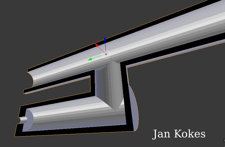

Here is another suggestion (blue arrow up, green arrow towards target):
This option lacks the drawbacks of already stated options:
1/ Nobody behind you will get blast of gases as in second option, or get hit by an object twice the mass of your bullet as in fist option
2/ It will be much easier to make (standard plumbing equipment), easier to clean (if joints are threaded) and less likely to suffer permanent damage than Spagin
Otherwise it will keep the benefits of Spagin, preventing both recoil and muzzle jumping up. The pinhole may or may not be required however it will make it less likely you will shoot the whole appendix off.

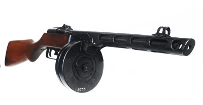

I don't get the PPSH reference tho? It's a big heavy gun firing a small pistol round, that's why it has so little recoil, i have a semi auto conversion on license and it still kicks tho :p Or are you referring to the barrel shroud acting as a crude muzzle brake?
What about using high pressures? Or actually narrowing the nozzle to create more back pressure? More like a Laval nozzle rather then the Gustav's "venturi" nozzle? Like adding a union fitting at the back and using washers with different sized holes until you find a sweet spot? More like the design of an RPG-7:jackssmirkingrevenge wrote:Not really practical, you would literally need a chamber about 4-5 times larger in volume before sufficient air was available for this to happen.
