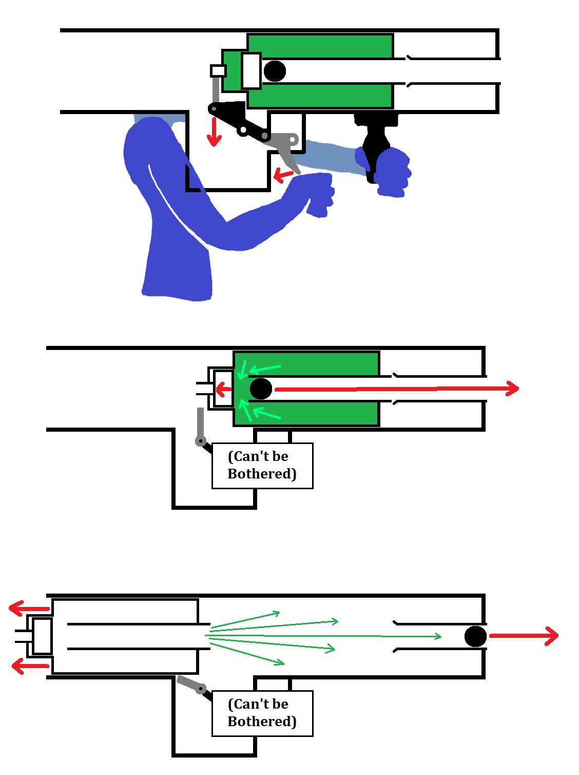

In any case I want to present this idea and you tell me what you think:
Launcher within a launcher
Maybe this could be improved by instead of having the fixed barrel extension segmented off from the interior launcher, make it enveloped as in arrow shooters, but whatever...
