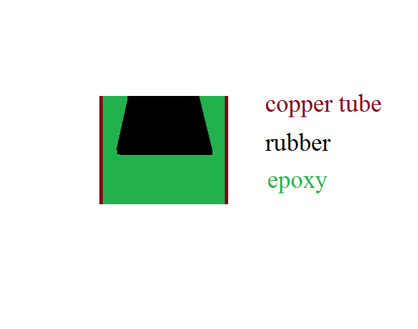

What I used to do, embed a piece of rubber into epoxy, keep it in place and stops the rubber piece from expanding duo to use.

smart! an anchor is what I need! Thanks!
Fri Mar 31, 2017 11:18 pm
It helps if you use thick rubber too, 1/4" thick will stick better than 1/8".
