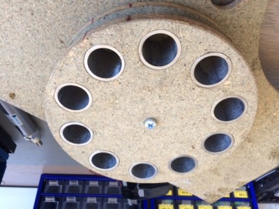

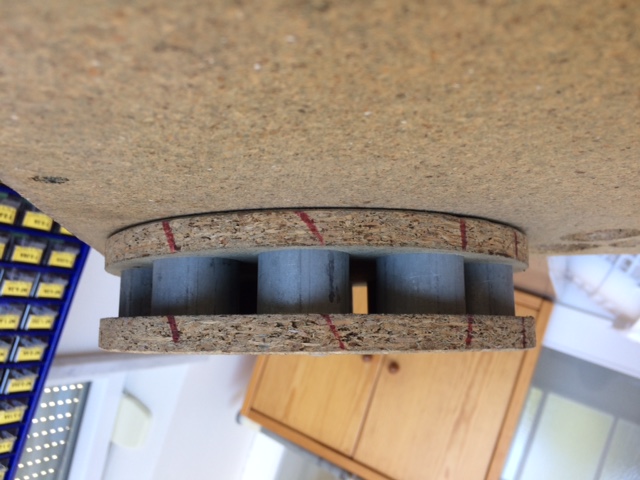

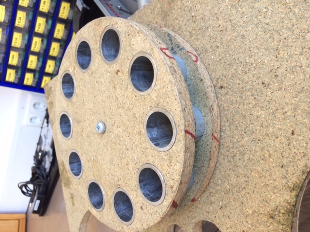

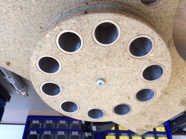

I want to build a fully pneumatic air cannon and one of my biggest problems is the revolver mechanism...
So maybe you can give me some tips how to move / rotate and lock the revolver drum in the right position only with one or more pneumatic cylinders
At the attached pics you cam see the actual construction...
I hope someone has a good idea!
Much greetings from germany
Thomas
Rotation mechanism Revolver pneumatic

Hey guys,
Thank you for the answers!
The eclipse project lead me to the mauser zig zag mechanism, which is a good possible solution i think...
The Second idea also Sounds good... hm we will see
Has someone furthermore ideas?
