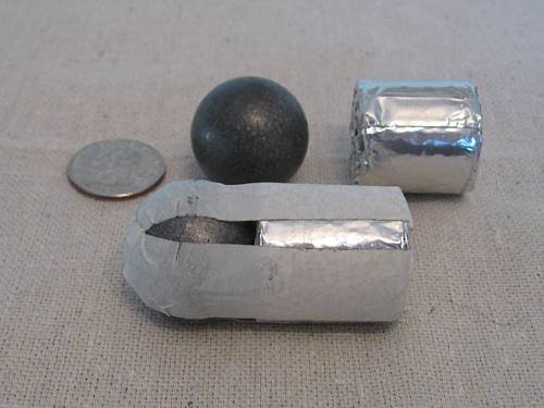

Sabot's ?

Sdr21 pvc pipe has an ID that's perfect for golf balls. I had to call around a few hardware stores to find one that carries it however (Canada). As mentioned, sabots are good but take time to make. I usually use Styrofoam cut with a hole saw that matches my barrel ID or simply rags stuffed around the projectile
