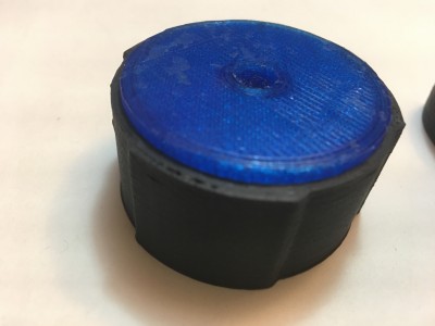

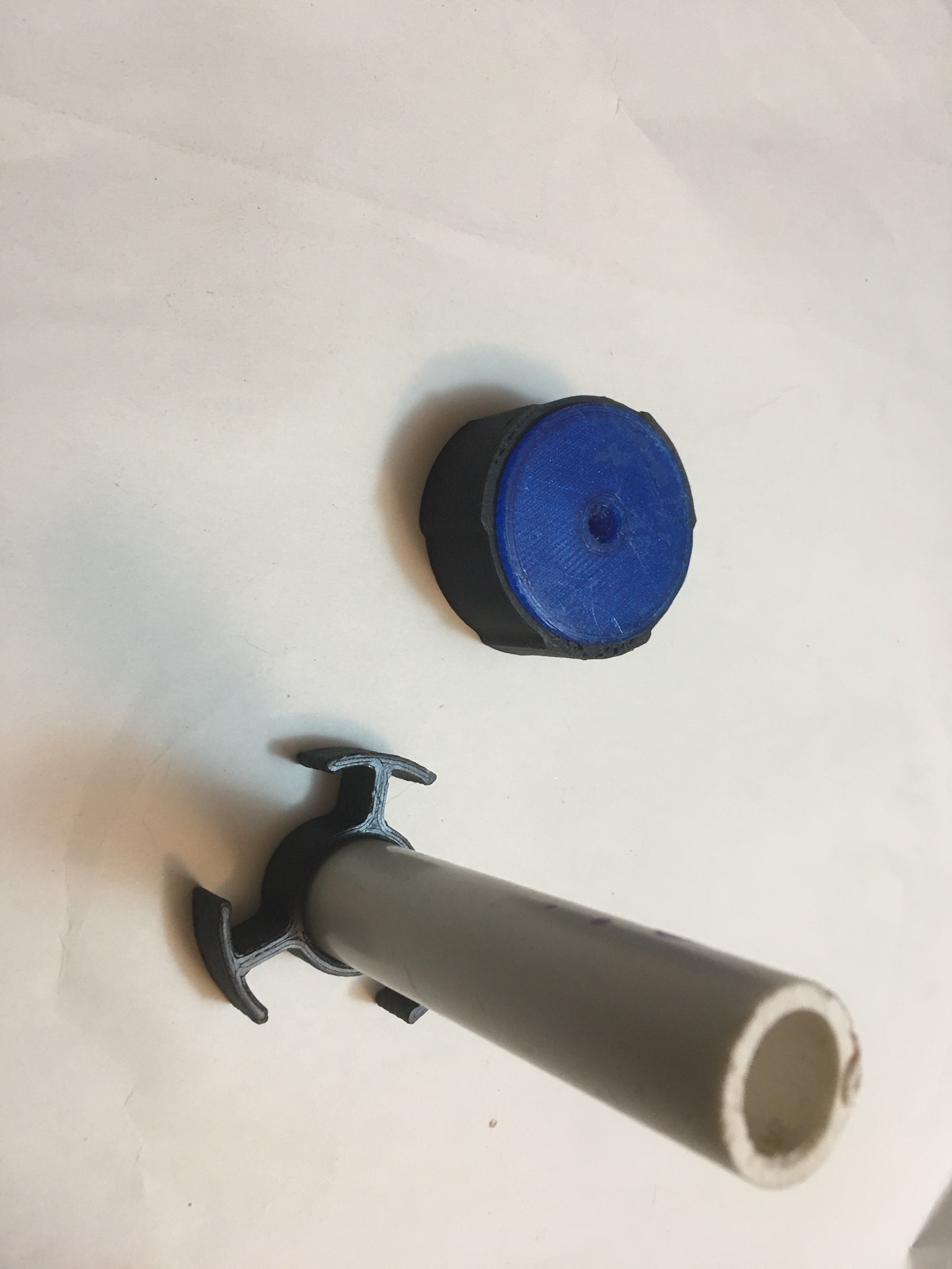

I drew up and printed some parts to make a 2” piston valve,

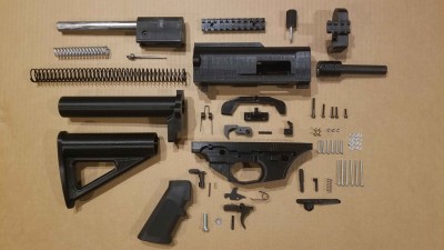

I have seen nerf guns(lots) special in the rival type, lots of prop type guns, and even real actual firing firearms in the 3d printing realm, but not much in the way of air cannons or combustion or air soft lets say spud files type
Anyhow was wondering anyone’s thoughts on this

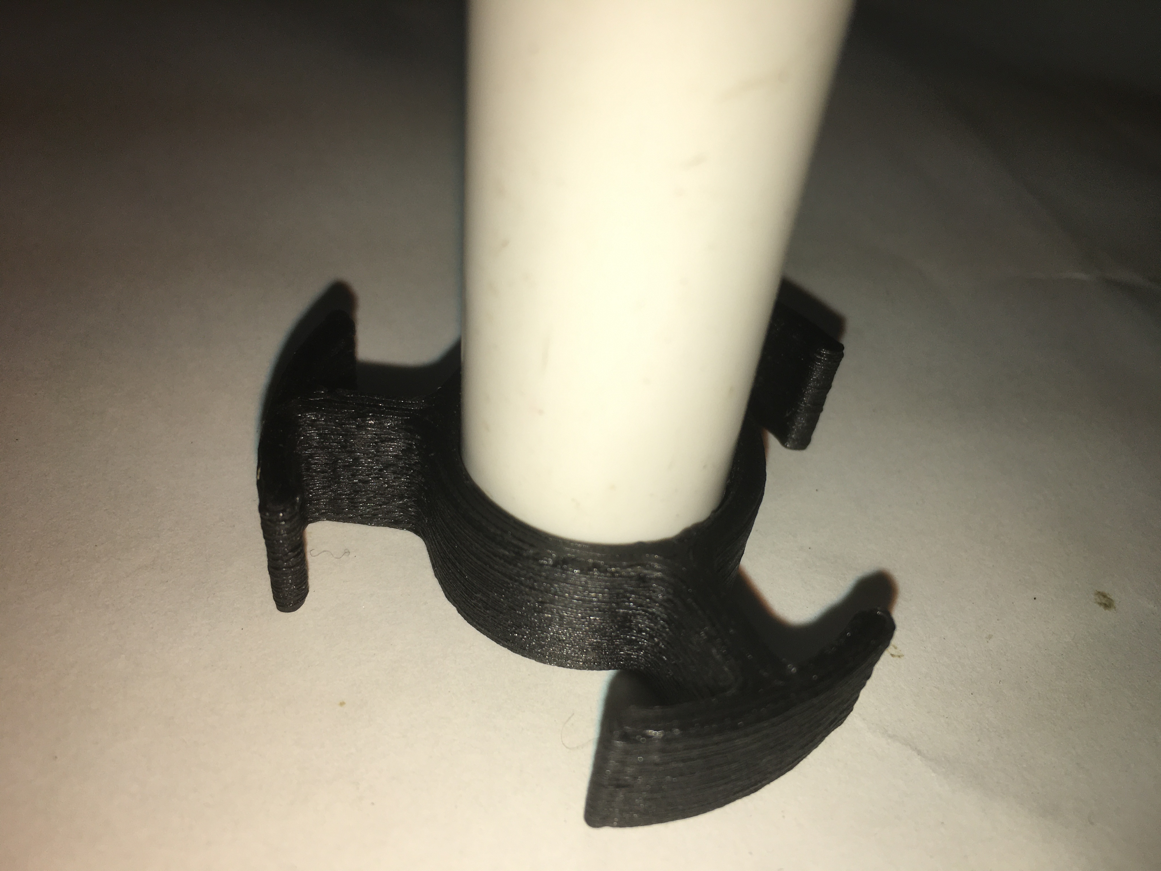

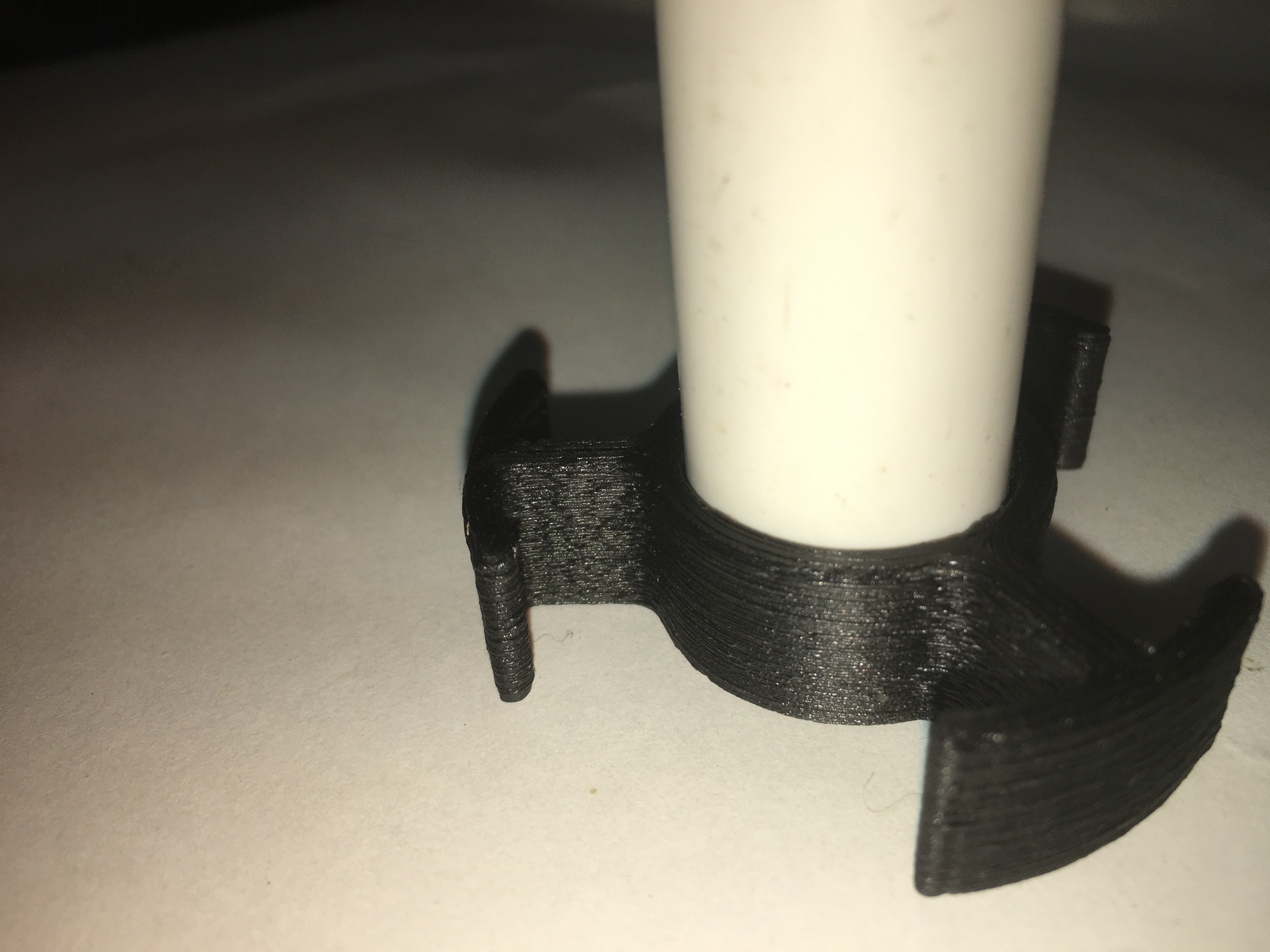

Below is what I printed the piston and the barrel alignment guide were printed with PLA carbon fiber

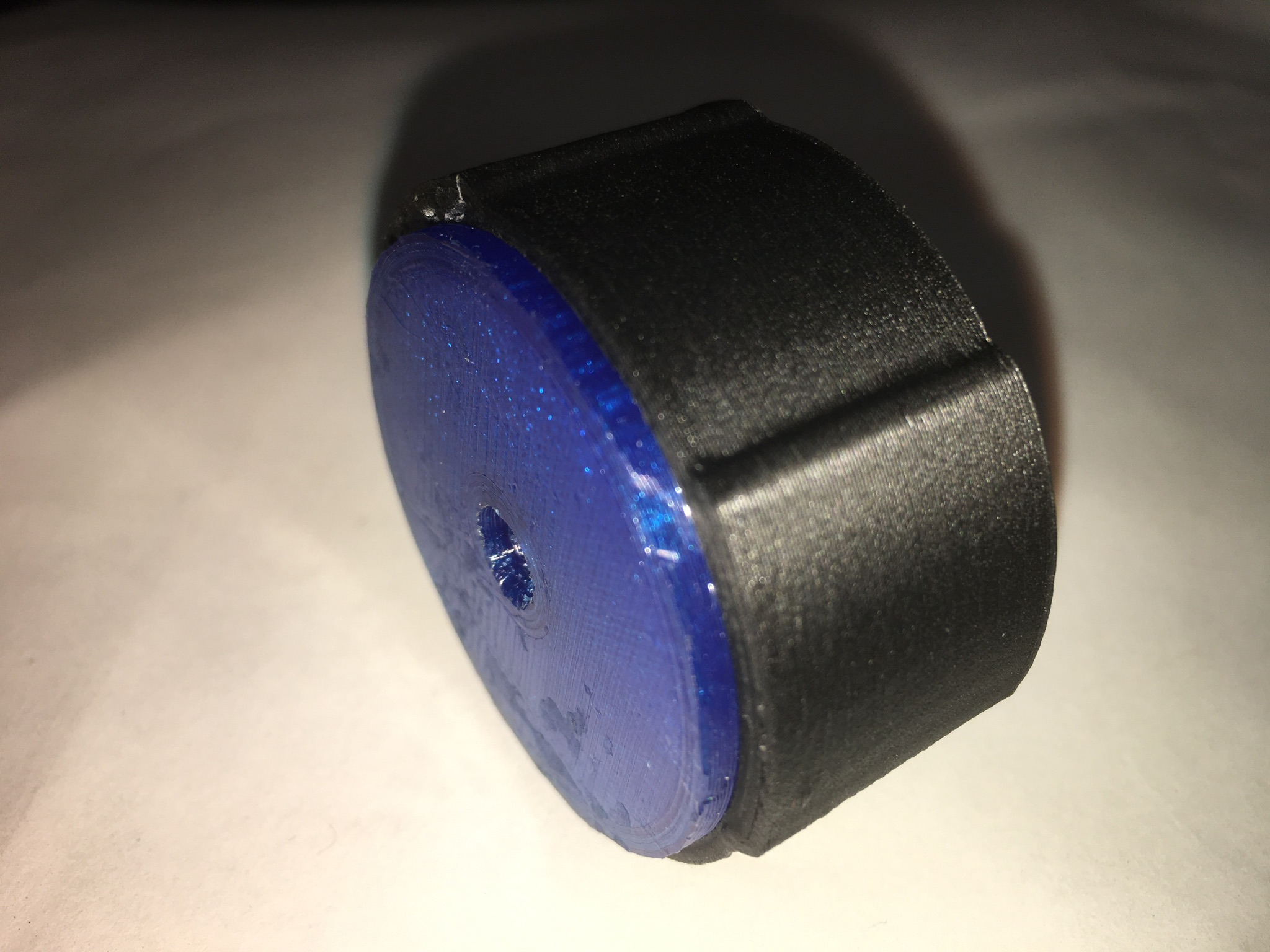

The sealing face of the piston was printed in Blue TPU

Regarding your piston, doesn't it need to be cylindrical in order to fit in a tube and remain airtight? If air can flow past the lugs and into the pilot chamber then it won't work.
I'm assuming you're going for a conventional coaxial design here.
The material advances in 3D printing in the past few years have been amazing, what previously I thought would have been impractical for structural parts is now feasible.

Yes i was going for a coaxial design the small groves were to allow the chamber to be filled past the piston or an equalization channels as there is none on the piston itself and a spring would also be used to aid in the sealing of the piston
New to piston valves so idk if would work the way i planned

You don't need them, in fact they are too much and it will probably not work as drawn.
If there isn't an o-ring, air is going to flow past anyway so you should make it as close to the outer tube as possible.
If too much air can flow past, the pilot chamber will fill up from the main chamber faster than the pilot valve can empty it, and it will never fire.

From my experience, you'll have trouble with the seal not sealing. I tried 3D printed piston seals and they don't seal.
I ended up just printing the pistons and glueing on a piece of rubber with epoxy.
Also you want the outside of your piston to be as good of a seal as possible. While loading, the air will creep around anyway.

Regardless of how much I'm annoyed I can never make the investment in time and resources to get started 3d printing, it is the future.
If you can make a 9mm carbine with 3d printed parts, there's no reason you can't make spudgun parts.
