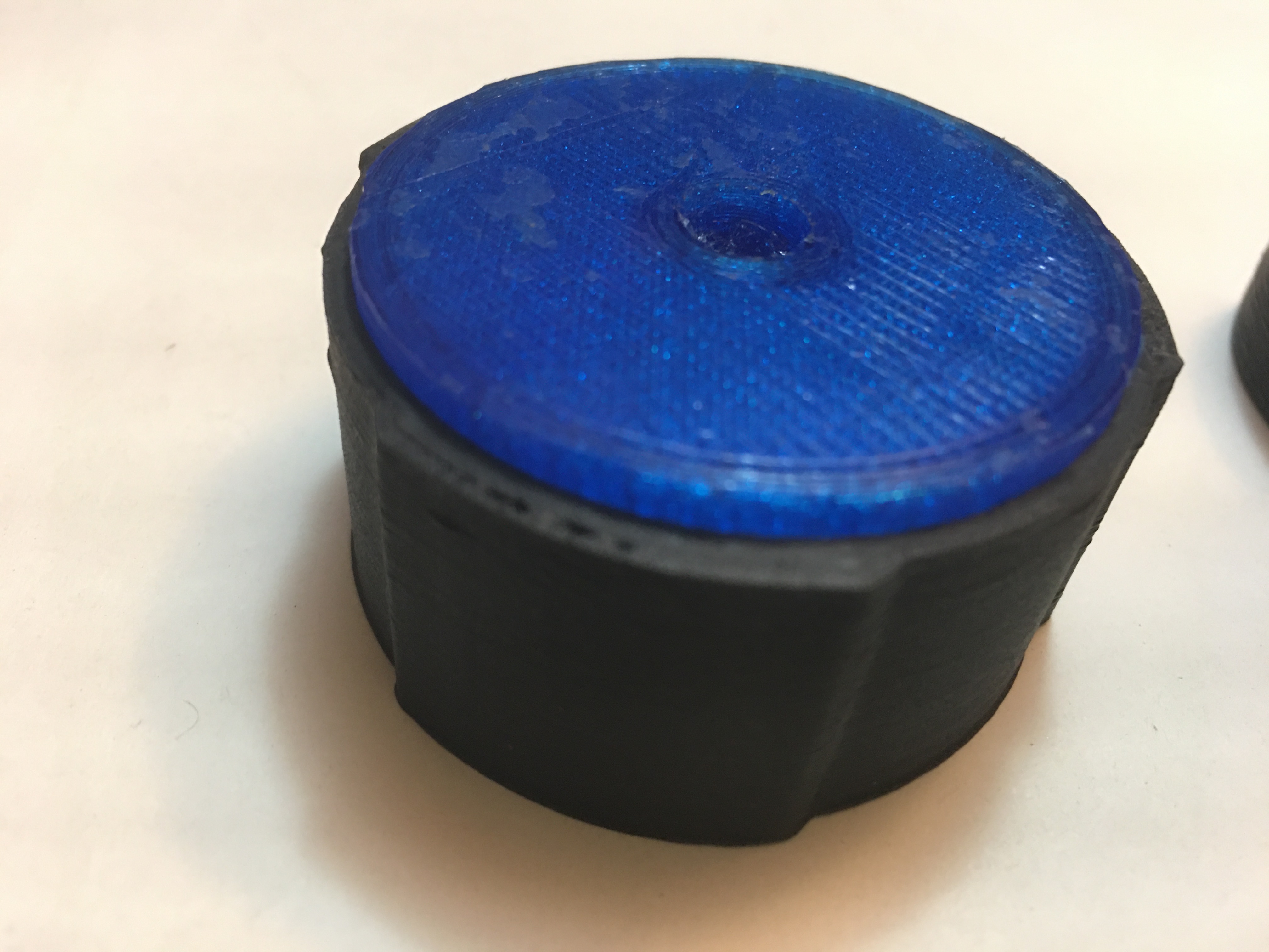

I drew up and printed some parts to make a 2” piston valve,
I have seen nerf guns(lots) special in the rival type, lots of prop type guns, and even real actual firing firearms in the 3d printing realm, but not much in the way of air cannons or combustion or air soft lets say spud files type
Anyhow was wondering anyone’s thoughts on this
Below is what I printed the piston and the barrel alignment guide were printed with PLA carbon fiber
The sealing face of the piston was printed in Blue TPU

Looks awsome, for things like pistons and internal components that sounds great. Im not sure if you have access but I would say something with glass fiber reinforcement would be preferential.
I would not recommend printing a chamber or any external components that may rupture and cause harm.

Regarding your piston, doesn't it need to be cylindrical in order to fit in a tube and remain airtight? If air can flow past the lugs and into the pilot chamber then it won't work.
I'm assuming you're going for a conventional coaxial design here.

Those parts look beautiful. I was wondering about the shape of the piston as well. Seems air would go by it. What kind of cannon is this for? As for 3D printing, I've been tempted to get into it myself to make interesting projectiles. I have ideas to 3D print camera holders to shoot from the cannon and record the flight. I'd also want to make something with a parachute that deploys for the ultimate version of those toys I played with as a kid. Maybe a parachute deploying capsule with a downward-facing camera that sends the view to a laptop or something. It could be used as a recon-cannon! A cheap drone would of course be infinitely better, but it would still be super fun.

Yes i was going for a coaxial design the small groves were to allow the chamber to be filled past the piston or an equalization channels as there is none on the piston itself and a spring would also be used to aid in the sealing of the piston
New to piston valves so idk if would work the way i planned
You don't need them, in fact they are too much and it will probably not work as drawn.
If there isn't an o-ring, air is going to flow past anyway so you should make it as close to the outer tube as possible.
If too much air can flow past, the pilot chamber will fill up from the main chamber faster than the pilot valve can empty it, and it will never fire.

From my experience, you'll have trouble with the seal not sealing. I tried 3D printed piston seals and they don't seal.
I ended up just printing the pistons and glueing on a piece of rubber with epoxy.
Also you want the outside of your piston to be as good of a seal as possible. While loading, the air will creep around anyway.
Finish the gun and tell us your experiences!:)

Somewhat surprised by that, I've been having quite good success with printing 95 TPU seals for old co2 guns. Maybe just lucky....which I'll gladly take.

several materials will work as seals like TPE or Flex PLA for sure and they both are easy to print but you want a much softer material for a seal vs a harder one
