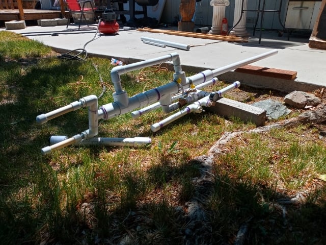

Here is the first prototype.
Short video firing 8 balloons. The gun in the video is a 3'' barrel.

Neat! We need a few more details on how it works, it looks like there's 3 sprinkler valves and the chamber can't be the whole length of that bottom pipe (or could it?).
Only suggestion I have is to pneumatically pilot the three valves instead of electronically. You can hear the diaphragm "honking" towards the end of the shot so you're probably not getting as much flow as you could if the valves were opening completely and staying open.

I plan on using a simple ball valve for the final design. I'm going back and fourth between a 1'' ball valve and 2'' ball valve. I did a couple test and they appeared to have performed the same. The 1'' is much easier to to open so I am leaning toward that.

You could also spring-load them or even just add a larger handle to the valve as well. I think with a few bucks worth of tubing/fittings, and a small 1/4" ball valve, you could really make those three sprinkler valves work a lot better as well though, all depends on what you want to do.

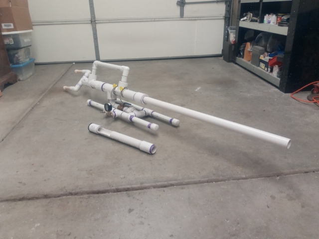

Here's some pictures of the 2nd prototype. Its a 1 1/4 inch barrel that allows a 2ft shell to be loaded. I built two different breach loading mechanisms I thought could work. The first is a screw in breach that has the air enter from the bottom. The 2nd is a cam lock where the air enters directly from behind via a hose.
I need to decide which design to go for. I would like to get some opinions.
As far as cool factor, the screw in system wins IMO. It feels pretty fun to use. The breach has to be screwed out via using handles on the back that act as a crank, then pulled out and pushed aside to load the shell in. Once the shell is in, do the motion again in reverse to ready the shot. It feels like your using a real gun. I could see the whole movement being invigorating when your with a team of people doing rapid firing on enemy positions.
Here is the video where I got the idea.
The cam lock system seems more practical. The screw in system requires the air to enter from the side or bottom rather than directly behind. Requiring special shells to be made that has slits in them in order to let the air through in those directions. The slit also takes up real estate on the shell, leaving less room for balloons. The shell and possibly the gun would have to be a bit longer in order to have the same amount of balloons you could get with the cam lock design.

Just as a matter of opinion: cam locks all day every day. :P In a mounted configuration like yours screw breech works well enough, but any usage where the barrel is free to move in any other axis than forward/backwards (and rotating) they become very annoying.
