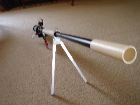

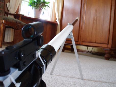

This is my newest sniper,well really my only true sniper.The gun Features a black paintjob but i ran out of paint and couldn't finish the rest of it so the muzzle flash and the barrel support have no paintjob.I made my bipod from some square bar aluminium i had lying around which is attached to the barrel support and with some metal srew ties.

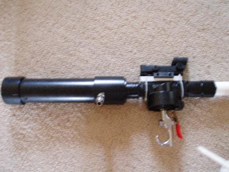

I fill the cannon using a male compressor adaptor with a 1/4 ball valve,but i lost the little lever so i have to use a pair if plyers to open and close it.The valve is just your standard modded sprinkler but with the blow gun connected to the bottom with a nipple going into the valve.

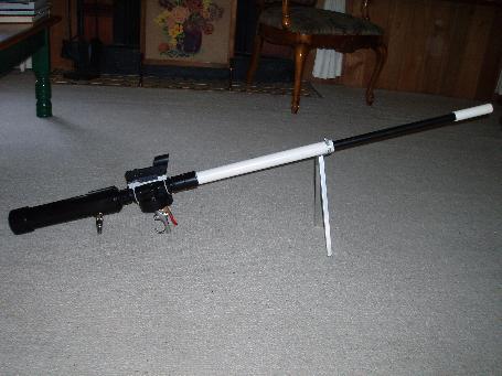

The whole cannon on its bipod stand i plan to pain it all black when i get more paint.
Looking down the barrel and sights,looks mean doesnt it :P

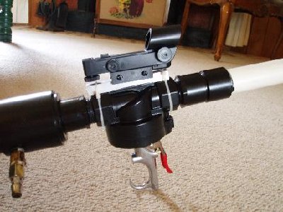

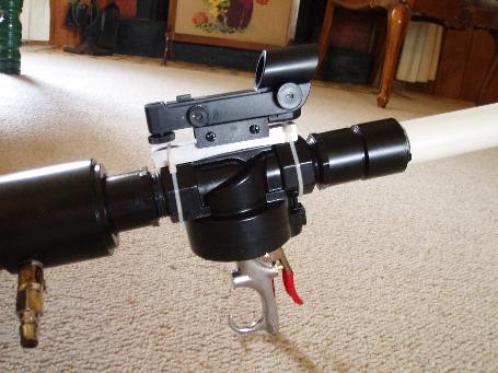

Side view fo the valve and sights.
Front on view of the muzzle flash hider and the bipod.
My valve,chamber and optical sights.

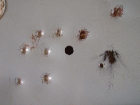

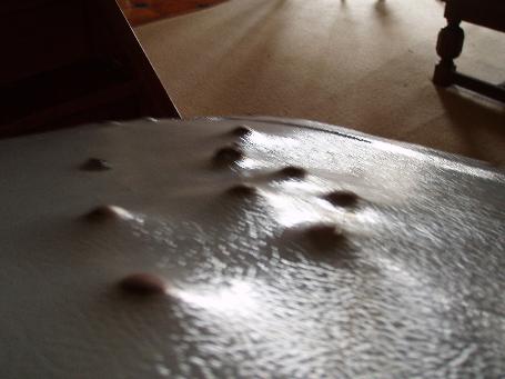

This is some shots  at sheet metal from my cannon wiht marbles.

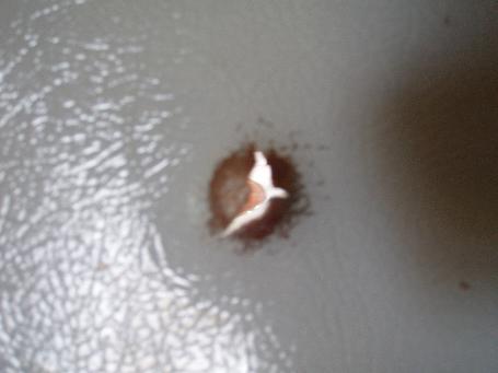

This is were the marble nearly goes through at 20 meters and at 130psi.

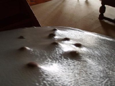

This is a side view f the metal sheet i shoot at and the dents from the marbles.

Will you guys stop attatching your scopes with tie-straps?
Seriously, I've made dovetail rails in less than 30 minutes using a file...

you do know that that is a red dot sight off of a telascope right?

beebs, so wat if it is a red dot sight off a telescope, it hasnt got a rifled barrel so it isnt like you could shoot it with pin point accuresy anyways, and scopes in australia are so hard to get with out paying an arm and a legg for, so this is the best we got over here and it just adds to the hole look to the gun, so stop being so picky and just admire the craftman ship that has been put into this work of art

get yourself a weaver rail, drill and tap for it, and mount the red dot on it. if i were you i'd sleeve that barrel too to keep it straighter for better accuracy.

Why don't you just glue the scope on? Can't you get a hot glue gun at the dollar store? They're usually under 5 bucks, I use hot glue a lot when I'm prototyping.

If it works, it works. Its his cannon, a very nice one at that, so he can do what ever he wants. It would look better though if it was on a scope rail.
