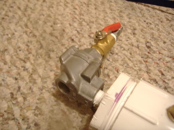

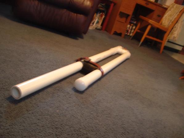

The cannon itself is rather simple. The main thing here was me working on the valve. It is a barrel sealing tee valve based in a two inch tee with 1-1/2" porting for ALMOST unrestricted flow for a golfball. Even with the tenth of an inch or so on the choked diameter, they still go out of sight.:D
The chamber is about 36 to 48", (I didn't really measure it), of 2" SCH-40. I was gonna use 3" but for simplicity's sake I just used 2".
The barrel is 2" SCH-40 with 1-1/2" SDR-26 sleeved inside of it with spacers. The barrel, while it is not SDR-21... works beautifully! It's only .03" larger in bore than SDR-21 anyways...
The piston is actuated by a 1/4" Q.E.V. bought off McMaster. The valve itself is piloted and filled from the same ball valve with a male quick disconnect end. This works great, even though it's not as "realistic" as piloting with a blowgun.

The barrel support is just cardboard tubing painted black and a belt, ( :P ), until I find something a little more permanent.
Full picture...
Full picture...
The pilot and fill system...

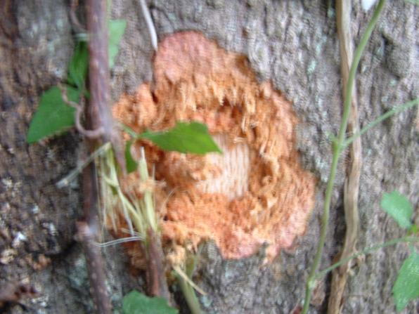

What will the environmentalists think?

Shrimphead: I used 1/8" sheet neoprene off McMaster as the sealing face.

lol, it seems like the golf ball goes in slow motion. It has a straight, fast flight path, but it seems to go slow. By the destruction however, I can tell it must have been going really fast :lol:

It was a blank at ~15 PSI, so it was fine.
Rmich: it's actually funny that the golfball dipped at the last second, hitting the flank of the board.
Velocity
Posts: 1039
Wed Aug 23, 2006 9:02 am
thats from the crazy spin that the golf ball picks up i think
