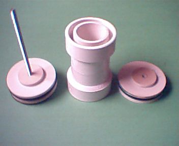

I have not made equalization holes yet.<br /> All disks were boiled and pressed from scrap pipe.  Disks were cut out on a vertical lathe (an old drill press).  Tell me what you all think.

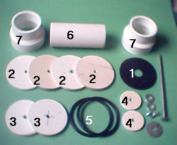

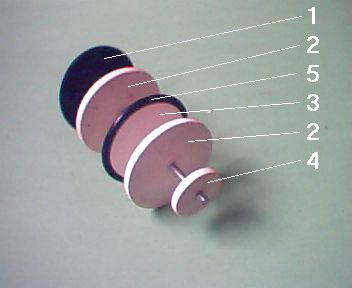

1.  3&amp;quot; rubber washer<br /><br />2.  3&amp;quot; pvc disks <br /> <br />3.  2 5/8&amp;quot; dia., 1/4&amp;quot; thick pvc disks                          <br />     (1/4&amp;quot; for ring expansion)            <br />4.  1 9/16&amp;quot; pvc disks (inside dia. of  <br />     1 1/2&amp;quot; pcv pipe)<br /><br />5.  AS568A-334 orings (2 5/8&amp;quot; inside, <br />      3&amp;quot; outside, 3/16&amp;quot; thick)<br /><br />6.  4 1/4&amp;quot; long 1 1/2&amp;quot; pvc pipe<br /><br />7.  2&amp;quot; to 1 1/2&amp;quot; bell reducers
1. 3&quot; rubber washer
2. 3&quot; pvc disks
3. 2 5/8&quot; dia., 1/4&quot; thick pvc disks
(1/4&quot; for ring expansion)
4. 1 9/16&quot; pvc disks (inside dia. of
1 1/2&quot; pcv pipe)
5. AS568A-334 orings (2 5/8&quot; inside,
3&quot; outside, 3/16&quot; thick)
6. 4 1/4&quot; long 1 1/2&quot; pvc pipe
7. 2&quot; to 1 1/2&quot; bell reducers

it looks a bit big, but nonetheless beautiful! I would love to have a lathe, but I cannot justify spending $300+ just to make oring grooves; its barrel sealers for me!

hit garage sales for old drill presses. You can find them for 50 and under

Wow. That is very nicely done. Is that for a barrel sealing piston or chamber sealing? (rmich, it could be for either)

thats a pretty nice looking piston, was any glueing done between the disks? or is it just held together by the bolt?

no glue yet. Wanted to be able to show the pieces.

You should use rubber sement to glue them because it would make a kind of like rubber padding and you could still take them apart if you needed to fix something.

It is for a barrel sealing cannon. I'll put it together this weekend.
