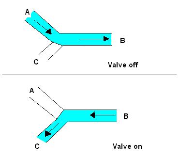

EDIT: I've dramatically changed my desgin and need a rethink on my valves. I've just stumbled accross some paintball 3 way push button valves... https://palmer-pursuit.com/ecom/product ... e798fc3a91 They are high pressure but I need them to work a certain way. I need the valve to instantly swith the air flow from (a to b) to (b to c)... If you follow. Going from a into b and then on the push of a button from b into c. I've attached a diagram to explain. Can anyone tell me if Im able to do this with these valves? I'm really stuck... (oh and by the way point b is the exhaust end of a piston cannon if that may aid in analysis.)
- 3 Way valve - 2 directional flow.JPG (10.74 KiB) Viewed 2903 times
