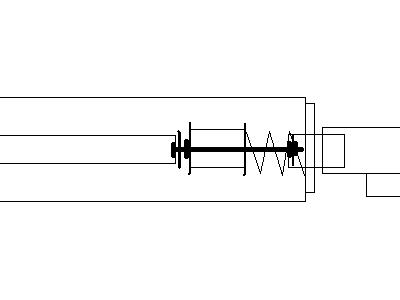

This is what the basics of my next gun are going to be. A clean mini piston gun like Mr. Plow did, except less than 1.5 cubic inches of pilot volume, which means insanely fast opening time if I use a sprinkler, which I probably will use. It's also going to be 2" sch 80 to eliminate couplers, or 2" sch 40 with orings and screws. I'm not sure of the barrel size yet, but maybe 1/2" SDR 13.5 sleeved in 1" sch 80.
There will be a long 3/4" nipple screwed in actually into the chamber with a tight fitting washer inside the nipple, with the spring around the nipple.
Mini Clean Piston Gun.JPG (7.74 KiB) Viewed 3167 times

Thats going to be really powerful because of how fast your going to vent the air. Cant wait to see it.

Can't wait to make it ( I still don't know where I'm going to get 2" sch 80). Should be pretty sweet. Then I can make whole T shaped barrel sealing piston valves using this design.
