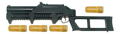

To be more specific I am looking for an ELECTRONIC FIRING SYSTEM or some form of a TRIGGER SYSTEM. Only there is a catch I am doing a mock up of a GM-94 Gernade gun and I am trying to enclose as much of the workings as possible. So I was wondering if anyone here has any ideas on how I should go about this. Any Valves that work really well. Things people have tried. Anything would help. A push in the right direction. Oh and I forgot it needs to Be Pretty SMALL ( under 3' total length).

(this is what I hope to be close to when its done)

that shoudl be ablout all you need to know. To make it look like your pictured gun, you'd have to house it in a wooded stock.
