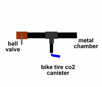

i don't know, i haven't done co2 with pvc because all i've heard about it was bad, im sure you could get away with it a few times but each time your pvc would be more likely to blow. if you want co2 just do something like this.
<a href="http://biketiresdirect.com/productdetai ... 33">here's a link to the bike tire inflators</a> you can buy them just about anywhere
edit: oops forgot the link to the post mentioned below <a href="http://www.spudfiles.com/forums/viewtopic.php?t=244"> here it is</a>
these bike tire inflators use 16 gram co2 cartidges and you can control the amount of co2 that goes in with the twisting on/off knob so you don't need a whole cartridge for one shot if you have a small enough chamber. here's a post that explains the chamber volumes and amount of psi with 12 gram cartidges, i don't know how much it would be off with 16 grams.

yeah, but if you have a large chamber your 800 psi thats in the little cartridge expands a lot so it's not 800 psi anymore, the same idea as the way a big tank takes longer than a tiny one to fill to, let's say, 60 psi with a pump. the post about the barrel sizes expalins it as well
