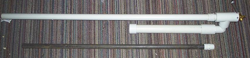

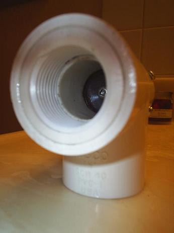

I really love making piston valves now. They are so much fun and so powerful. I whipped this one up in about an hour or so including the time I spent staring at the wall because of a short attention span that day.
<img src="http://www.spudfiles.com/uploader/uploa ... naldo6.JPG">
From the picture, it may or may not look like some gigantic beast to you, but it's actually a 1" porting valve. It's more powerful and better looking than any sprinkler valve, that's for sure. (Maybe not those 2"ers.)
<img src="http://www.spudfiles.com/uploader/uploa ... naldo7.JPG">
So I stuck a 3 way pilot on it, a 1.5"x16" chamber, a 4'x1" barrel (Also 4'x3/4"sch 80) and I was all set.

Does anybody build stuff like this on a whim these days or is it just me?
Oh, and the name. I didn't know what to name it so I asked Mr. Plow. He said Ronaldo. So his name is Ronaldo.

Another great piston valve! I love how you grind down the hexigonal part to fit in the valve. I will be making another piston valve now. Maybe a 2inch one. Good job. By the way would you tell me what you use as a sealing face?

Anyways, looking good. I really like piston valves that are done on lathes; did you modify those bushings? It appears so...

Yes, I did modify the bushings. For some reason I like to take the hexes off all the valve parts and countersink them perfectly but I don't do anything for the rest of the gun. Hahah.
To andswer Amadeus's question, I use 3/32" soft neporene sheets from McMaster. I order it in 4"x36" sheets. I might go longer for the next order. I've used up this last one pretty quickly.
