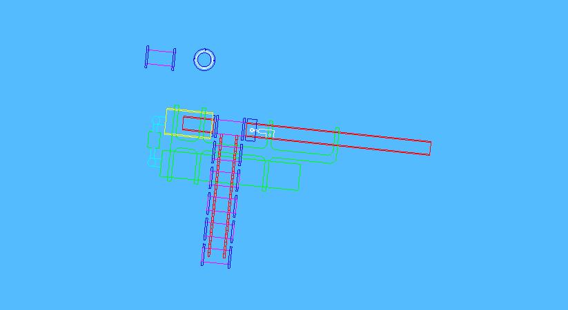

I am going to build a chainfeed remote controlled t shirt cannon for a demo truck we are building for the CES show in Las vegas. My question is what type of air compressor would i need to mount in the truck to get a good rate of fire? I was thinking a shot about every 15 seconds.
