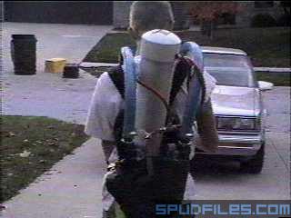

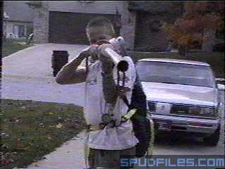

This is a cool gun, mainly because it is so unique. I need to fix this thing up for this summer... everyone thinks it looks like the Proton Packs from Ghostbusters heh. Ryno is holding it for me in each picture.

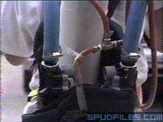

I use a 2' piece of 4" for the chamber. 2 1" sprinkler valves give this gun its power. 1" PVC air hose connects the valves to the barrel attachment. I have tennis ball, pop bottle, and bouncy ball barrels for this cannon. Here's a look at the back of the cannon, and a closer look at the innards. I'm using a 1/4" ball valve to trigger the valves. Blowgun does not have enough flow to trigger both of the valves.

well it looks to me that the small hoses are used to fire the actual cannon, they are both hooked up to two sprinkler valves which trigger the cannon, then the compressed air that is stored in the large white pvc container in the middle of the pack is discharged into the two large blue hoses which seem to cometogether and come out of one single barrel.
