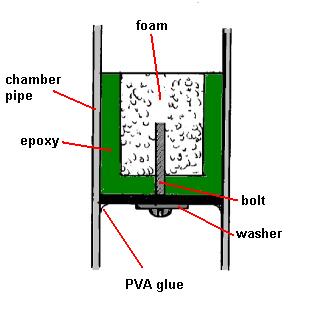

Sun Apr 29, 2007 9:45 pm
cast it out of quality epoxy... though at that scale, I think it would get pretty expensive.
cast epoxy pistol construction (vertical)
