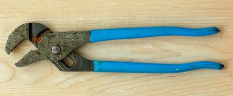

I am assembling the cannon now, and I am having some trouble tightening the endcap and elbow onto the main chamber nipple. Underwater they leak like crazy, and i dont have anything to grab on to to tighten them. Anyone have any suggestions?

pvcmaster wrote:I am assembling the cannon now, and I am having some trouble tightening the endcap and elbow onto the main chamber nipple. Underwater they leak like crazy, and i dont have anything to grab on to to tighten them. Anyone have any suggestions?
Try using an adjustable wrench like this one:

Or you could just use a proper pipe wrench.
