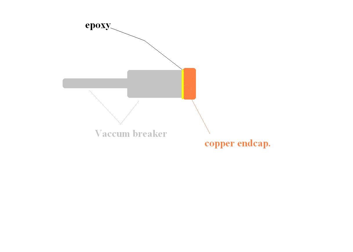

Look at this diagram, pretty much self explanitory, And you fuel it by spraying your fuel down the barrel, or add a 1/4 inch ball valve to the end of the cap, and spray it through the ball valve.
- vaccum breaker.JPG (26.51 KiB) Viewed 4752 times
Ohh yeah...there is copper pipe. I forgot about copper pipe.
