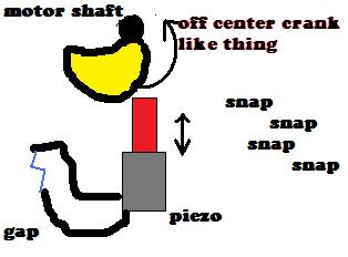

FWIW sticky, that "off center crank like thing" ( :lol: ) you show in your graphic would usually be called a "cam"....or possibly an "eccentric" follower, arm, or cog....
