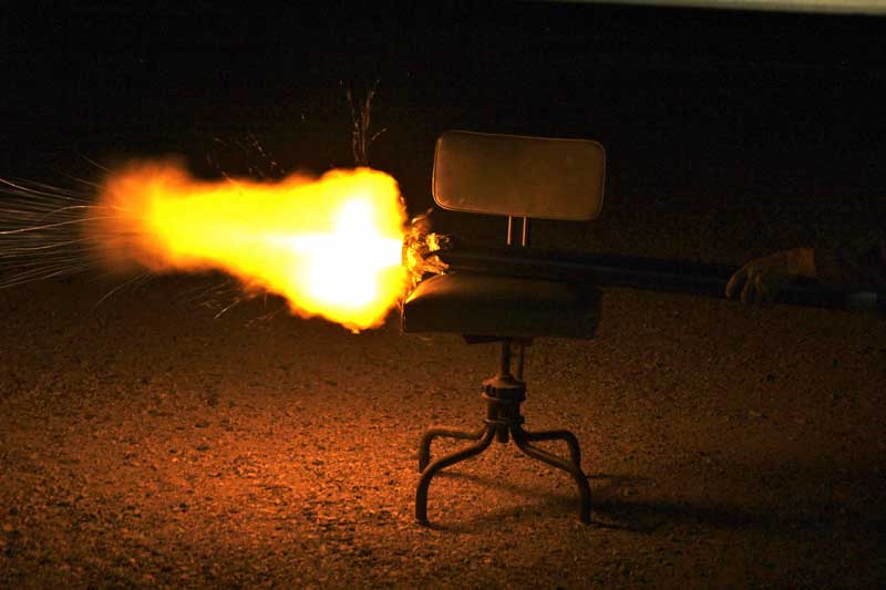

I am new to Spud files and I thought I would share my Hydroxy spud gun.
I am posting this to show everyone that water burns !!
This was originally designed to be a tennis ball launcher, the ignition is a BBQ igniter which works fine because of the low ignition energy of Hydrogen.
At half power it launches a tennis ball at 360 kph (Measured with Go-Pro camera), any more and it obliterates the tennis ball.
Hydrogen mixture is produced with a dry cell (1.5 lpm) from water and KOH mix.
Please feel free to comment and let me know what you think !

That muzzle blast is beautiful, welcome to spufiles!
What sort of generator are you using? Homemade? I've wanted to make a small one for a while but I got lazy lately

Nice photo of the muzzle blast. And good production rate on the electrolysis rig, that's impressively cheap, even if you have to replace the plates with 316 yourself. I've considered doing this a few times, but I ended up taking the route of just renting oxygen and hydrogen tanks, mostly because my application required significantly higher supply pressure.
